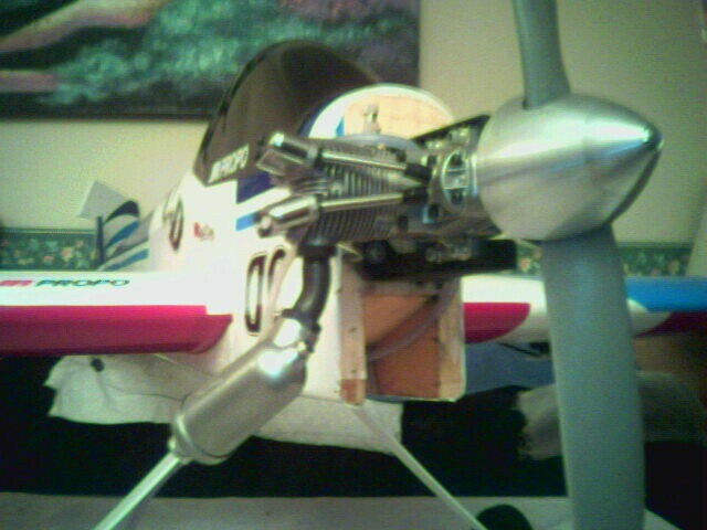

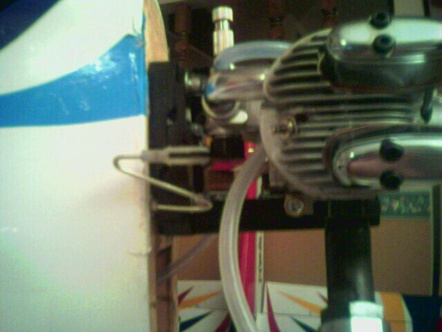

Jared, your gonna love this combo. mine is the most fun tho fly in my hangar, ive only had one plane i liked as much and it was my ucd46 with saito 100
this plane goes up forever(fast) if you like vertical and is very economical on fuel after you lean out the low speed needle , so if it seems like a gashog then remember that your still to rich on the lowend,(this is a common misconception about saitos).
ive had my ucd for over a year and had this engine on since beginning of feb and love it
here are some pics.

this is my first saito...well my first 4-stroker to be honest. I've flown with 2-strokers since i can remember cause I could never afford a bigger, better engine. I'll have to remember that about the low end needle, that will save me alot of frusteration.
Curious, where is your CG set at? Mine is set at the stock location, but thats a little conservetive
for my taste. Do you balance with a full tank of fuel or dry? speaking of fuel, I was told to use 30%
heli fuel for this engine. true?
last question, You have your engine mounted sideways...does that improve the carb flooding problem on the UCD?
Nice low inverted pass!!!

my cg is at 5.75
balance with a mt tank
30% is ok but you dont need to spend the extra dollars because with this plane and engine combo 15% is plenty.(and i like a little castor in mine, good for the cam and bearings)
and yes it aleviates all flooding probs without spending extra dollars on regulators.(thats why i did it)

hey gjeffers, when you mounted your engine sideways, did you have to drill new holes in the firewall, or could you use the existing holes? I'd like to try mounting mine like that, but i might not mess with it if i have to drill
Old 04-10-2006 | 07:12 PM
gjeffers's Avatar
Joined: Sep 2004
Posts: 2,307
From: Round Mountain , NV
Default RE: U-Can-DO .60 with saito FA125
same holes 3D
ya just have to be creative to hook up the throttle linkage, but you can do it

ya i saw your little "Z-bend" kinda thing....very clever! I like! I may have to steal your idea with that. i had another question....Its been descused several times before, but, UNIFLOW....
I made my tank into a uf setup, i just hope i got the lines setup right?? a clunk on the carb line, a clunk on the exhaust line, and a fill line...correct or am i an idiot?
