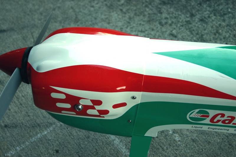

Where are you guys finding tne green/ white Castrol 232? I went to the Airborne website and only found the yellow/red Breitling one. Was there a model change? Thanks
