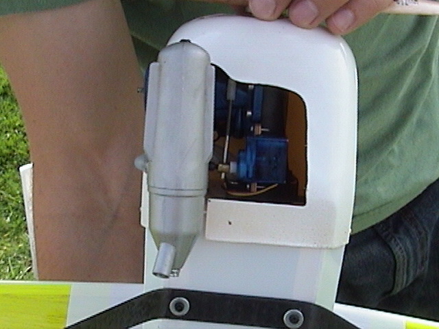

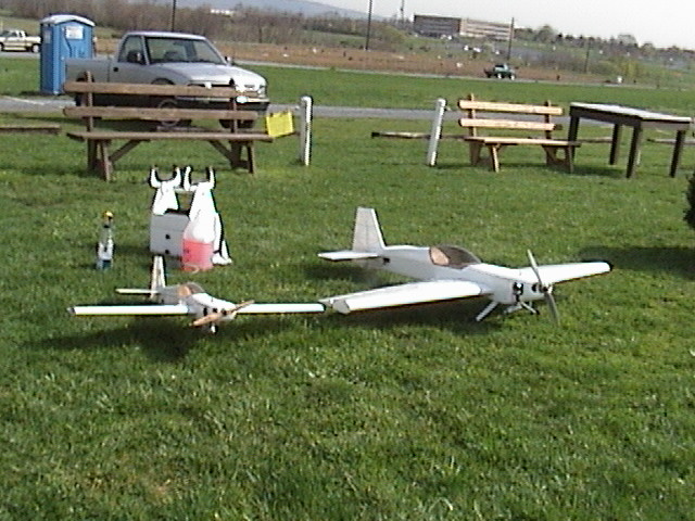

And you never said you cannot run a glow on a Mini-Funtana. Someone at my club just finished one. Here is a video of it. By the way it looks, it's like having "foamy power"

hey, this is my plane. it's a 25 LA i had already. i had it on before i recovered the plane and it as very heavy. i stripped it and recovered it with microlite and lost about 4 ounces. it seems to fly a lot better now that it is a 26 ounces dry. before it was 30.
i have a 9-6 prop on it and it does not seem to want to stick around long in a hover with it.. so i will try a 9-4 or 10-4.
the saito 30 would be so cool in this thing! if i had the money, i would do it in a second. then it would even SOUND like my funtana 40 with saito 100!
i seem to get around 15 minutes to a 2 ounce tank, so compare that to 15 minutes from an 11 ounce tank on the big one.

Yep, it's whaturi's plane and it's a pretty amazing setup. Tons of thrust. We have a pretty good wind today and the plane and pilot handled it very well. I've tried to fly mine on electric in the same wind and forget it, it's not happening. Power is not the problem, it flexes so much it gets squirrely in a hurry. His is much more stable with the changes he made
I'm hoping he adds more to how exactly he did the throttle setup and such. I was just posting the video because I have seem multiple peopl say it cannot be done but this one works very well.

for throttle, i made a servo tray out of plywood and screwed it to the motor mount. it was like that when the engine was on my trainer, so i just left it.
with all the power this thing has, i would think a hot .15 would still work very well and be even lighter..which is a good thing. the saito would be the sweetest!

a 5 cell 300 mah. before i covered the plane, i hot glued it into the turtle deck as far back as i could.

i am not home right now to take pics, but i basically just mounted the engine like normal. i did re-do the firewall with nice strong 1\8" ply. i also rebuilt the landing gear supports. the biggest thing with this plane is that it must be kept light. i would highly recommend covering it with the lightest stuff you can (microlite) because even after that, i am on the edge with weight. any more weight and it would not be very good to fly.
