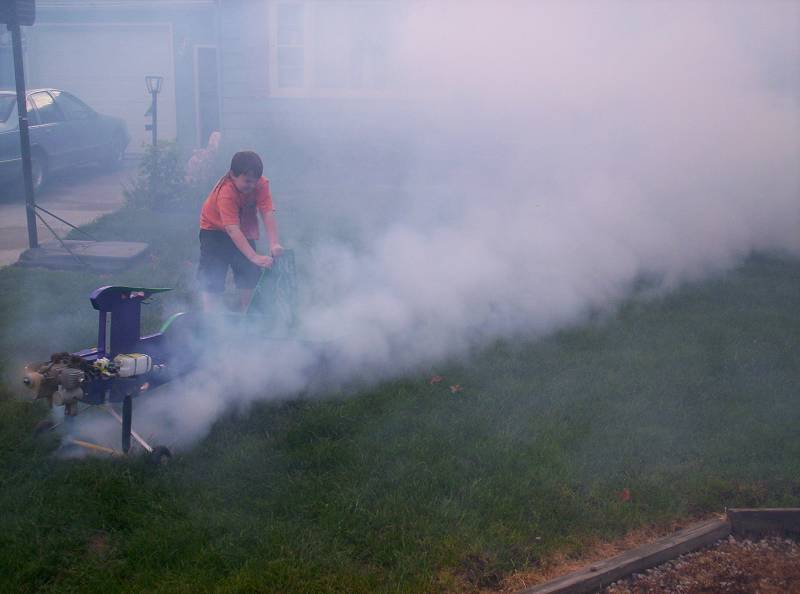

This plane is Bad ***** when doubled in sized and powered with a 120cc gasser. Just added smoke too. I'm gettting ready to add a .90 Super Tigre to my small one. I'm also going to enlarge the control surfaces just like I did with the big one.
