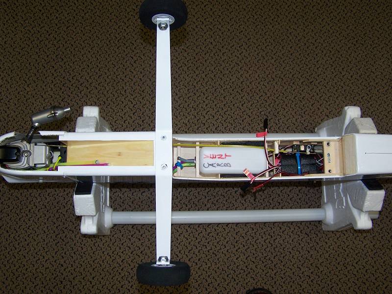

Another tip.Go with carbon fiber pushrods. The stock pushrods are too small. They are 2/56. A bare minimum would be 4/40 stuff. But if you go with carbon fiber you can use the 2/56 hardware as they will be stiff enough. The best place to get them is Central Hobbies.
You can see mine in the picture above.
The stock pushrods will not let you get the performance you expect with this plane.
Barry
