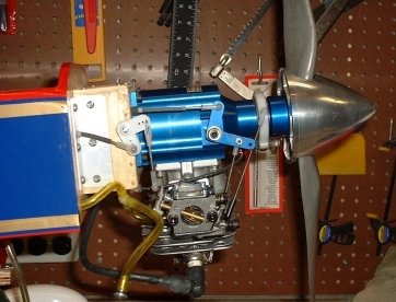

Works great. Use a micro servo to save weight, and put the servo on a knob so that you can use partial choke settings. Here is a picture on a choke setup on a Brisson 3.2.
