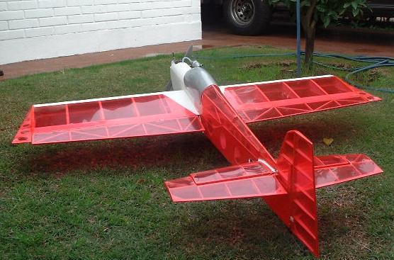

...What plane is pictured on your Avatar? Laser3D? Looks cool :thumbup:

Thanks, It`s my own design and pride.... it pretends to mix the lateral area and airfoiled tail of a Seduction and a diablotin wing, I love this plane, really

Yeah, I thought it looked kinda "Diablotinish". How much does it weigh and what engine r u usin'?

after rebuild?? hehe (the tx runout of batteries)... it weights 2100 grs, I`m using an OS46fx 12.25x3.75 prop that gives enough authority to pull out of hover but sometimes it wants to quit...

Sure is pretty, has 3D written all over it. Did you use the same airfoil design of the Diablotin? I've got a Super FG (not finished yet) and thought the airfoil design was interesting. My buddy's got an XL w/ the same airfoil and it flies soooo slow. Oh, are your wings two seperate halves w/ wing tube?

I have used the eppler169 airfoil, never have the oportunity to put my hands in the coordenates of the double reflex airfoil of the diablotin but the one I use gives me nice results, stable upright and inverted elevators and very slow flying but it will not instant break at idle; after the crash I added a little dihedral to correct pitch down tendence with rudder and now it does nice stationary flat spins!!
If you have the chance to modify the tail add airfoil to the stab it sure worth the effort, more authority AND more control
The wings are made of 1 piece
Thanks for the interest

What is the advantage of airfoiled stabs? Is this that the stab does not "stall" when high deflections are used?

I like the looks of your plane, Are plans available ?? Contact me please

thanks, sorry but no plans and I`m still doing some mods
