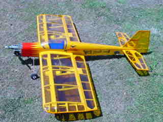

I bought one. It flys great and looks good. With the covering I have found it abit hard to orientate in the air. I put a Rossi 45 with a long pipe in it. I havnt test flown it with the new enging but it went quite good with a 46.

Im going to learn how to hover and see how it goes

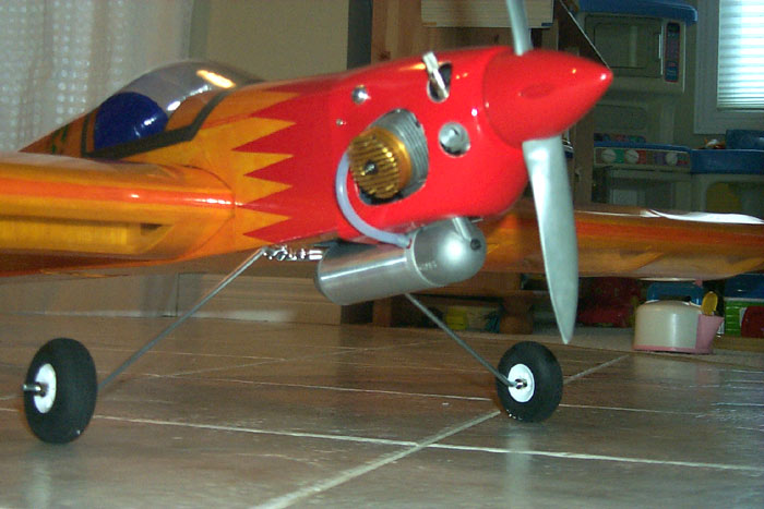

Just a couple of pics. I am using a GMS47 with tuned muffler. It just fit without modification to the supplied mount if anyone is considering it.

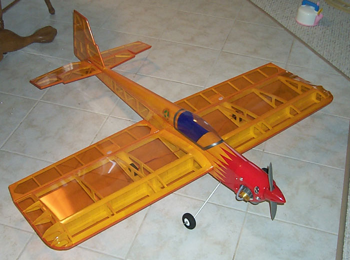

Top

Just bought one here in Aus for $170.00aus. And thats a "No Favours" price, not a "Mates Deal". $170.00aus is pretty good I reckon... Havnt got it in the air yet, but looking forward to it. Great to see the GMS 47 will fit, thats what I'm putting in it...
Hey Terry, what Prop is that? I have a APC 12 1/4 x 3 3/4 which that could almost be... Theres guys here prop hovering ARF trainers with 46FX's and GMS47's and those props; worked OK on my Arrow, but the plane was a little heavy...

cmsrp,
I'd have to check but I think it is a 12x4 or so. Believe me...the GMS 47 has more than enough for this plane. I flew it last weekend and the throttle spent most of the time just above idle. I am thinking of swapping out the stock tank for one half the size. One of my flights was 25 mins long and I landed under power. I still have some CG things to work out but its a fun plane and seems to be strong enough too. I did some high speed walls and it handled them fine.

Terry,
Try a APC 12 1/4 x 3 3/4 prop. You get heaps better throttle/thrust control and the plane doesnt fly real fast. We found out about the APC prop's when our club held the state pattern championships. Some of the pilots were using real cheap trainers (they reckon if they crash, for $120.00aus, they just get another one) for 3d fun during the breaks. No-one could beleive they were hovering etc using .40's and .46's etc in these trainers. Turned out the trick was the prop!!!!!!!Of course after that, most of our club members raided every hobby shop in close proximity for these props... Even my really heavy arrow became a pleasure to fly!!!!!
