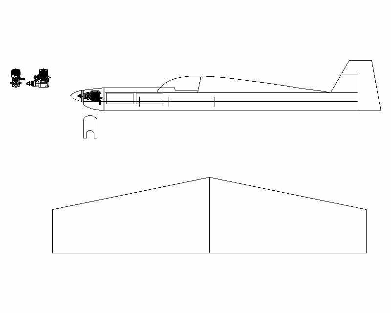

I'm starting a plan for an all-around beater that can fly 3D with a two-stroke .60. I've been looking around at some of the available stuff (it's all arf's?) to get a feel for what area and weight I would need to meet, but everything that claims to be .60 size actually is .90 size. Any advice? Seems like a .46 sized airframe would just be the tiniest bit too small and the .90 would be quite a bit too large. Has anybody had success with a regular ol' OS .60FX?

Funny you should mention that, I've got a 60 size original design profile on the boards right now! I agree, the 60 sized motor seems to be an orphan engine these days. I think the 3D numbers game has done that, needing the right power to weight ratio with a light enough wing loading. My ship will have, I can't remember exactly but its in my design book, around 880 sq in of wing area. Span is going to be 42". I like to keep the span short and the chord large to keep the center of lift close to the fuselage. That helps keep wing rock out of harriers. My numbers aren't far off from what is found in many "40" sized machines. What I will do is play around with moments to get the right CG without needint weight in the tail. That's one of the nice things about scratch building. Best of luck with your project. Don't cave. Stay with it and build your own!
Dave

AeroDave, what weight are you shooting for? Looking at Tower they say the GMS .61 will turn an 11x7 @ 13k. That's realistic enough to work from, so inputing those specs into ThrustHP (flawed, but workable) shows a realistic 1.6hp and 7.42lbs static. Using that hp rating, but changing props to a 13x4 shows a rather hopeful 13.39lbs static. These numbers sound like a 5-5.5lb airplane might 3D pretty well. How realistic do you think those numbers are?

AeroDave, if you want to learn how to keep the fat out of an airplane, you've got two choices. 3D or 1/2A. I took the latter route. www.ulmer-rc.com
Here's a very, very early design picture:

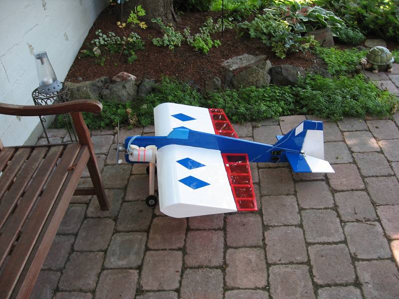

I've had good luck flying my Kangke Fun 50 with an OS 65LA. Lots of fun for the dollar investment. Standard servos and receiver and an OS 65LA make this plane fly well.
