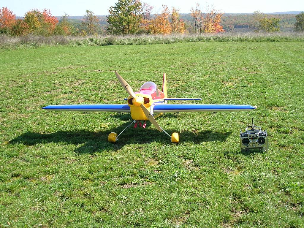

Yes! As a matter of fact I just maidened mine a couple months ago after having put in on the back shelf for a few years. I'm sorry I didn't finish it sooner.
This plane flies awesome as an electric conversion. I had to build a battery box on the firewall in order to get the CG forward enough.

looks great. no muffler holes. I too put mine on the shelf for about 2 years. Now I am sorry i did. having more fun with it than any other plane.

I did replace the gear on mine shortly after I took those pictures. I could not find the Chip Hyde double vision gear anywhere - seems to be no longer available.
I installed a one-piece Graph Tech Main Gear for the Extreme Flight 74" Yak (#244). Fits the Bling perfectly - the width on the fuselage is identical. It sits about 2" higher and has a lot more "spring" to it than the stock metal gear. It also has a fair bit of sweep which I think looks great with the sweep facing rearward.
I really wish they'd bring this plane back. At least almost all the parts are still available...
