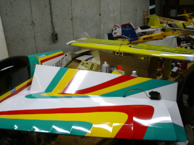

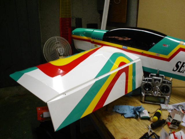

I purchased a prototype 50CC Seagull ARF ($185!) on Ebay a couple of weeks back and it appears to be in the same family as the new Bling. Has a glass canopy painted black, different colors, and the elevator servos mount in the horizontal stab. instead of the fuse. Otherwise looks and measure identical, must have been a prototype? The wing chord is 22 inches at the root and about 17.25 at the tip, including the aileron. The ailerons are 32 long and chord tapers from 7" to 4.25 for an area of 180"sq each. I'm guessing thats where the need for 2 servos each comes from. Appears to be well built and pretty light. Pictures to follow..... Do a google search for harrier 50CC, and you'll find a video from somewhere.

Here's the pics..... PLease excuse messy workbench There's a standard servo and a JR 9303 in there for reference in some of the pics.

wing construction looks the same with no sheeting from the leading edge to the spar.
Is there four servo bays in the wings of yours? I would only use 2 good ones anyway to save weight.

It has mounts for 4 servos....
