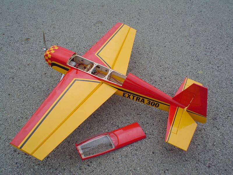

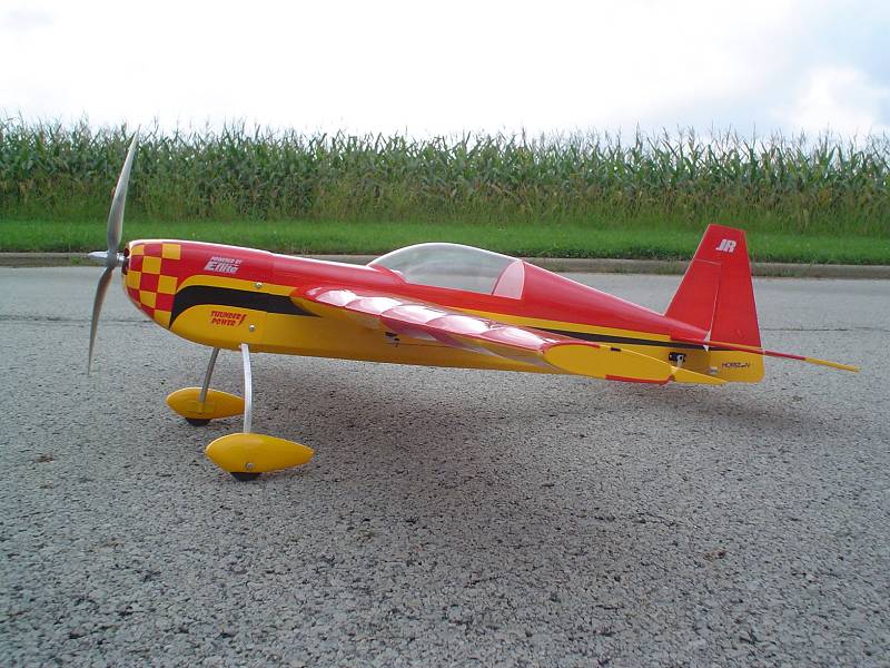

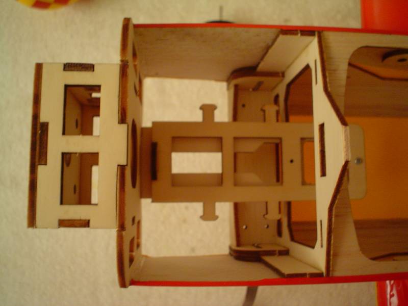

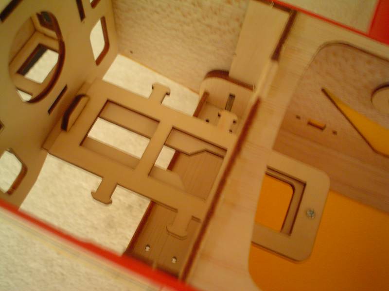

im very pleased so far with the fit and qaulity of this plane. theres some minor concerns but flying and time will tell. this plane has very little left to assemble and should go together in about an evening when i have time. theres a nice instrument panel applied in cockpit and theres no need to glue canopy down its already secured from the factory. the battery mounting is a little different.. theres a tray system to install battery in plane/i'll probally modify this later for easier use. the landing gear seems rather strong and the wingtube is made of metal.. these are two areas you could probally cut down on weight if needed. i plan to set it up by the manual and later add a tail wheel and make changes or modifications as needed for my type of flying.

The gear i'll be using for this build is as follows.
E-Flite 480 outrunner 1020kv with 12x6e apc to start
E-Flite 40 amp esc
4 hitec hs 65's
thunder power 2100 3 cell pro lites
Spektrum DX6 Radio

well its finally done. its still raining.. hopefully the skys clear for a maiden today. AUW came out to 31 ounces.. no excessive glue or anything i'll see how it flys and decide if i should cut some weight.

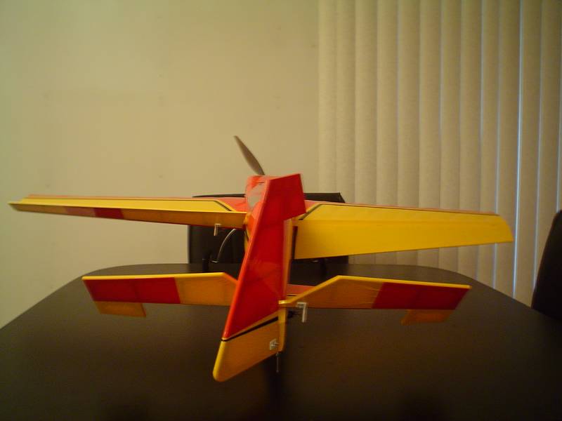

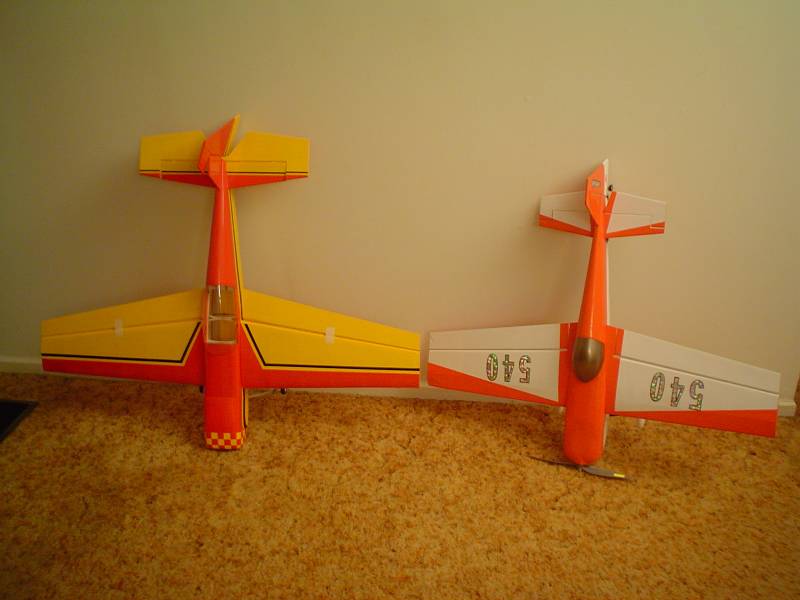

ok let me start by saying im a newer pilot and no 3D pro.. that being said heres my findings. made two 8 minute flights in windy conditions.. could fly longer on packs but didnt want to come up short on power trying to land in cross winds. i became comfortable with the extra fairly quick. it does an excellent knife edge.. very little coupling with my set up.. inverted is good with minor down elevator.. rolls are nice and sharp/loops well without snaping using moderation on elevator.. it can snap at higher speeds when maximum elevator deflection is used.. this results in around a 6 to 8 foot diameter loop/on more conservative rates it loops very well and straight. it tracks very well and holds lines good even in the windy conditions i maidened mine in. flat spins were nice inverted but didnt try them upright/stall turns aka hammerheads were very nice. harriers were nice but i did get slight wing rock and it was probally do to the wind. it hovered well with good control with little torque roll tendancies. did i say it knife edges well ? i started knife edges a minute or two into the maiden it does them very well. the hardcore guys or gals may feel its slightly underpowerd for extreme 3D but mine came in at 31 ounces so it isnt gonna rocket vertical with the 480 like it does in 18 to 25 ounce planes like ive used it in before.. vertical is respectable but not "FOAMY POWER''. i think sport pilots like myself will really like it and hardcore 3D pilots will like it but want a little more power. it flew very precise for me.. snap rolls were quick and sharp. im using hs 65s all around so it helps with response and crispness during aerobatics. first thing im doing is adding a tail wheel but that will be about it for now. very pleased with first two flights.
My Set Up:
E-Flite 480 1020kv
E-Flite 40 amp esc
APC 12x6E
Hitec hs 65s x 4
Thunder Power 2100 Pro Lite
Spektrum DX6
