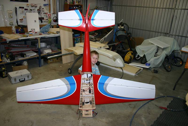

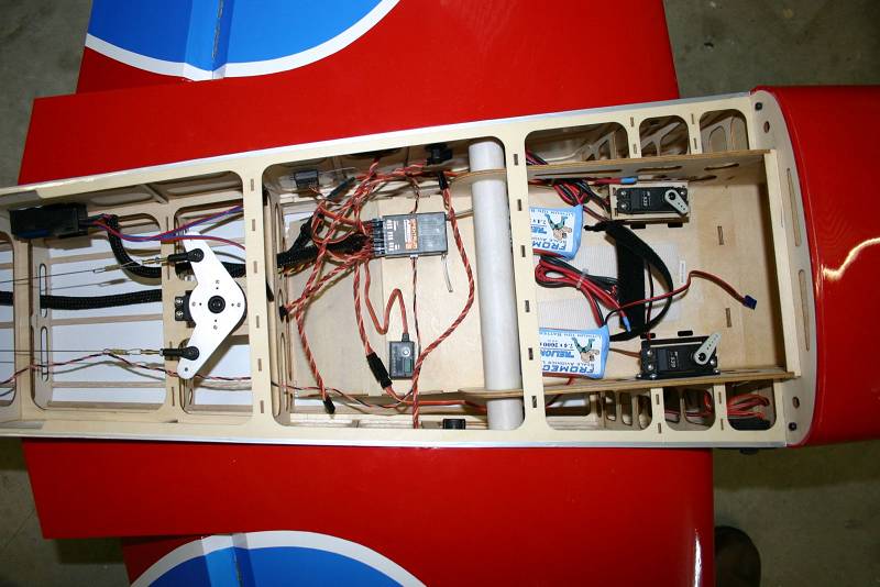

Here a few more pics, the alloy servo arms and canister muffler arrived today. I will try and get it ready for the weekend now.
I cut the covering from the under side of the aircraft and made up a removeable plate with cooling slots for the canister muffler.
I also need to tidy up my wiring.
What is the best CG to start with on this model

Old 09-25-2007 | 01:48 PM
  #245
Banned
Joined: Jul 2005
Posts: 1,791
From: Port Orchard WA
Default RE: Aviation Models/TOC 30% Extra 260 BUILD THREAD
Where did you put your fuel tank?? I have mine just in front of the spar and have balanced the plane with the CG 6" back from the lead edge without fuel. Inverted flight is hands off. This subject does seem to be a matter of huge debate with the guys on this thread so you may want to check with them also instead of just going with my numbers.
Yeah, where are you gonna put the fuel tank if you're running a canister? I would assume on top. I put my tank in where the tunnel is and there's not much room left. I set my cg at what they recomended. It flys pretty good to me there. So far your build looks good. Good luck with the maiden.
Old 09-25-2007 | 10:24 PM
  #248
Banned
Joined: Jul 2005
Posts: 1,791
That would be my next question. My only guess is that the electronics up front are just there temporary for the picture. Otherwise the tank goes in the tail! Good luck on take offs if that's the case! LOL
Old 09-25-2007 | 11:19 PM
  #249
blunderbum's Avatar
Joined: Sep 2003
Posts: 84
From: Adelaide, AUSTRALIA
My tank is going on the top deck just in front of the wing tube between the throttle and choke servo's. I will locate the two fromeco batteries to balance it out. I think I will stick with the manufactures recommendations for the CG and fly the 45 deg up line to check. TIA
