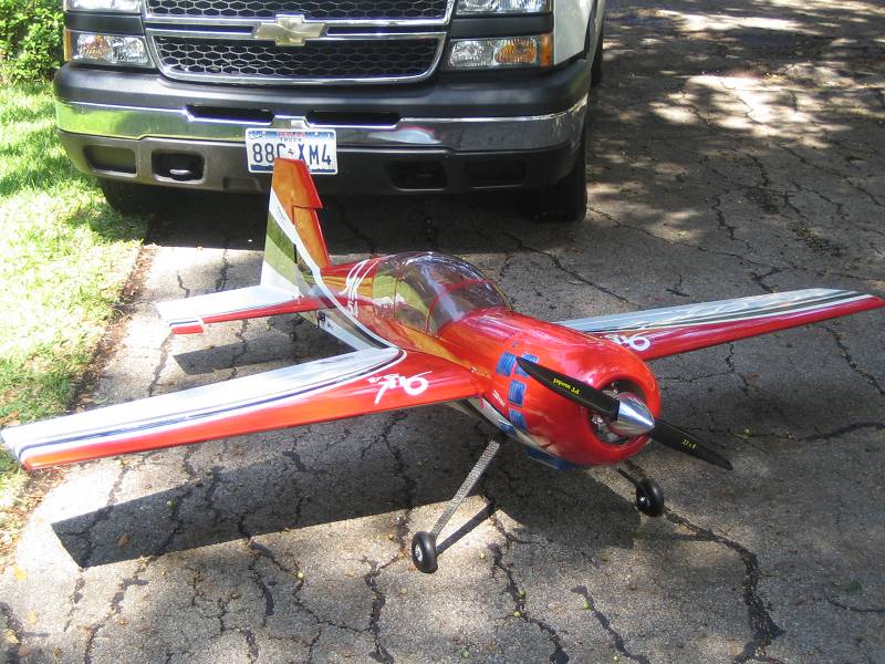

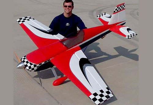

Well, have to assume no one else that reads RCU has done one of these - search came up empty... so I ordered mine, and it's arriving next Friday.
I'll be doing it with a Brillelli 60, JR digitals, and will post the build here.... in size, wing area, and target weight, it seems real close to the TOC and BME 30% Yak, and mine is a sweetheart of an airplane combo.
If anyone knows of a build thread, or other info on this bird, let's hear it!
(Pic attached is Garrett Morrison, borrowed from Aviation Models website until I post MINE!!!)

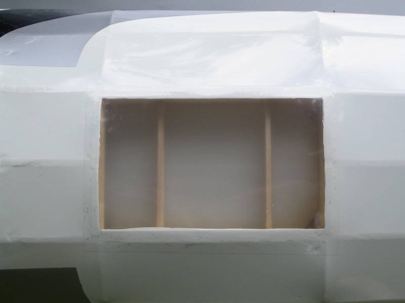

I have their Yak and the cannister tunnel extends back past the wingtube. If you mount a 20 or even 24 oz fuel tank in the cannister tunnel you can get it right on the center of gravity. Thats what I would do! I have my smoke tank up on top the of cannister tunnel just infront of the wing tube.
I also cut the square out of the bottom of the fuse where the tank mounts and added clear ultrakote so I can check my fuel level while hovering. You can cut a small hoole in the back of the cannister tunnel with a dremel to check fuel level or you can just pump untill you see gas running out of the vent like. Thats what I did and even with the DA 50 all the way up front it still took about 5-10 flips to get it to pop with the choke on. Plumbing was simple!
I would put the tank in the cannister tunnel!
