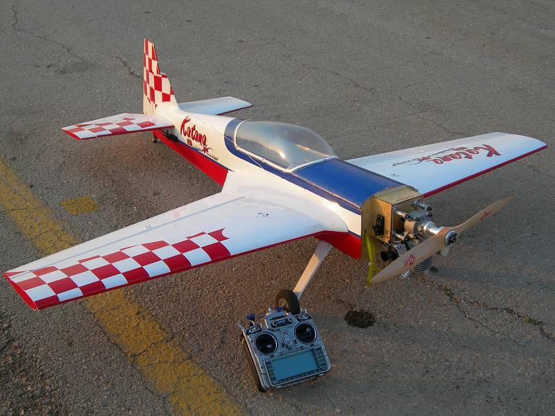

hello!
recived my BCMA SPE 40cc from ADAM,
the engine installed and fit with out changes to my plane CMPRO KATANA 140...
the engine look very good and should be an intresting results with this package
i'll hope to back with good resuls after this weekend (if the plane will be ready)
shot before instalation done----->

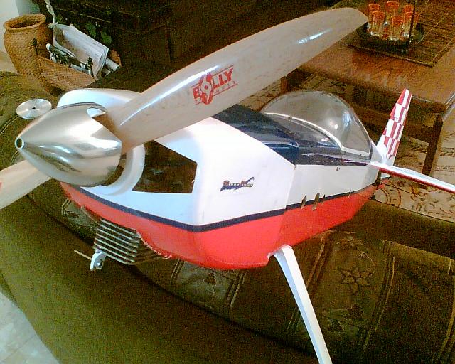

my bird finaly had a test flight, engine easy to start allways, pull at 90d like there is no tomorrow!!!!!
the plane flying very good also at smooth 3d (can't push the engine to the top-worked only 1galon...)
i can tell you guys that this engine in the best one for this bird for sure, HOVER AT 1/3 throttle with no problem...
test pilot: LIOR ZAHAVI www.liorzahavi.com
run with 3% oil mixing,20x8! BOLLY prop at 6,880 rpm --- that's nice for a brand new engine!
next week after borning more and more fuel i'll shot a video and uploud it...
NICE WEEKEND!!!
