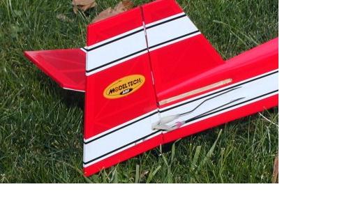

Old 01-17-2003 | 03:26 AM
GmanBill's Avatar
My Feedback: (10)
Posts: 407
From: Lake View Terrace, CA
Default Magic Extra
Mine is at 5" behind the leading edge , great flat flat spins, great hovering. All around great 3D aircraft. 46xls Magnum, standard servos. Do put support on the tail, triangle stock under and braces from the vert. stab to the horisontal stab on top. Attached is a picture of why I had to do a second one.
