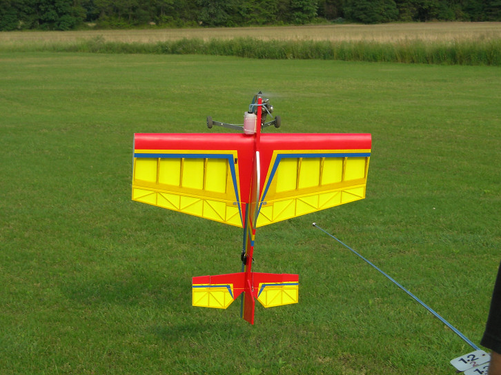

I use standards servos and a light NiMh pack too. Sanyo 720mah AAA 5 cell pack is about 2oz. Most .46 profiles fly best around 4 lbs, no need for expensive servos. I really slam the plane around and never had a standard Futaba strip.
Keep the cost and weight factor low and the fun factor will be high
