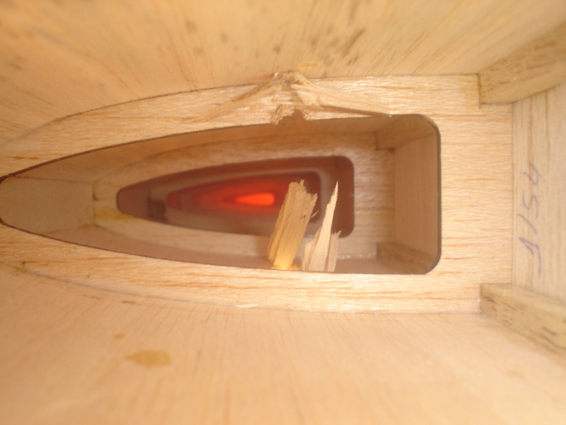

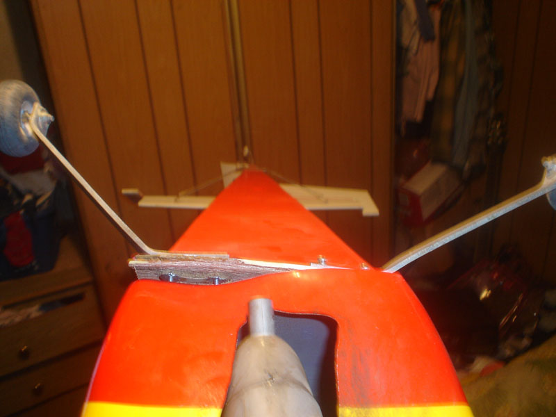

Another update:
On the ground, the engine ran perfect. I went to fly today and very shortly after takeoff, she died again. I didnt have nearly enough airspeed to land safely so she suffered quite a bit of damage. I still didnt hear back from horizon the first time I contacted them, so I contacted them again today. Im very worried they will not be willing to replace the plane that was damaged. Here are some pics.
