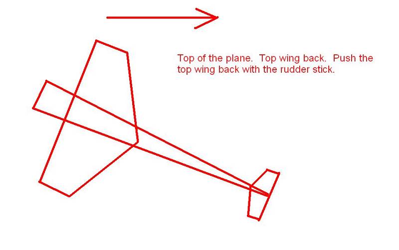

I've been trying to 3D and do all the really cool aerobatic moves for about 5 yrs. In a nut shell--I suck compared to most of you guys. I never could get the rudder timing down for the cool rolling harriers or the low n slow roll that requires opposite rudder during the time when the belly is pointing towards me.
My friend threw me a pearl on Tuesday night. He just saved me $10,000 worth of crashed airplanes and 2 yrs of suffering.
Top wing Back. Bottom wing Forward.
That mean anything to any of you fellas?

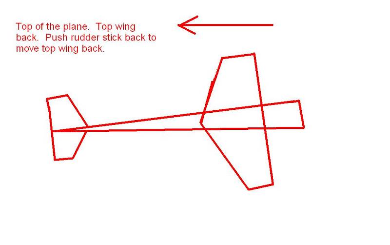

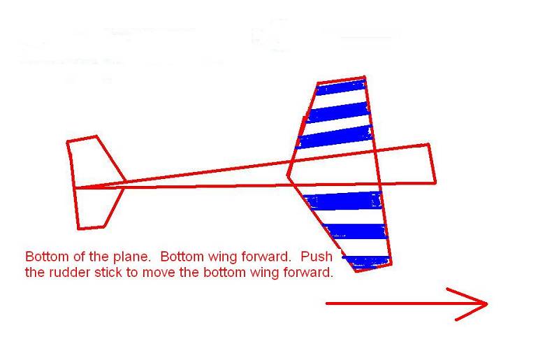

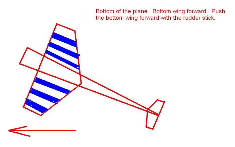

Doesn't matter. Left to right. Right to left.
Try it on your sim.
If your looking at the TOP of the plane--then you fly the wing on top. Push the rudder stick to push the top wing back and it keeps the nose up.
If your looking at the BOTTOM of the plane--then you fly the bottom wing. Push the rudder stick to move the bottom wing forward.
If your looking at the top wing--Top wing back
If your looking at the bottom wing--Bottom wing forward
When your doing low n slow rollers on the deck, it's very easy to get confused with the rudder and crash the plane. There is no room for error when the wingtips are 12" off the deck. You put in the right rudder corrections, or the plane is dead.
So, you break the plane up into top and bottom.
When you see the top of the plane--then you fly the TOP wing panel. Your looking at the TOP of the TOP wing . Move your rudder stick to bring that top wing to the back of the plane. Top wing back. This keeps the nose up.
When you see the bottom of the plane--then you fly the BOTTOM wing panel. Your looking at the BOTTOM of the BOTTOM wing. Fly the bottom wing. Move your rudder stick so that it causes the bottom wing to move forward. Moving the bottom wing forward keeps the nose up. Push the rudder stick "forward" to move the bottom wing forward. Whichever way the wing is moving--you need to push it forward to keep the nose up. So--you push the rudder stick in that direction.

RCPilet, that is the same key that I use.. Dont let the cute remarks get to you. Everyone has something they are looking at to key them on different things. Once I figured that out it was a major epiphany for me too. That is when I really got cranked up on doing integrated rolling circles and loops and stuff. It works exactly like you describe. It does not matter what direction the airplane is traveling, left to right or right to left. If the canopy is facing you, you use the rudder to push the top wingtip back to lift the nose (as if your thumb was actually on the top wingtip), if the belly is facing you you push the bottom wingtip forward to lift the nose(as if your thumb was actually on the bottom wingtip). Its a great visual association to help get things going.
Here is another one. When the plane is inverted steer with the inboard wingtip(the one closest to you.) Just as in knife edge, when inverted you imagine your thumb is on the inboard wingtip and you move your rudder stick thumb the direction you want the wingtip to go. This is easiest to learn in a loop. Just start doing large controlled loops. Use the ailerons to maintain wings level (ONLY) use the rudder to maintain heading. As the plane passes 9/3 o clock and starts to enter inverted you steer the inboard wingtip. As it comes upright you just work the rudder normally.
As bdavidson said.. once you have done this enough the achieve muscle memory you will not even think about it anymore.. Working the rudder in any position becomes a seamless action that you do without thought.
I know a lot of people dont like visual keys,, but they have been VERY helpful in learning to have total control for sequence flying and freestyle stuff.
