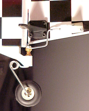

My tail wheel - Sullivan with my own linkage
