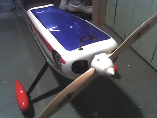

Posts: 132
From: Hampton, NH
Default RE: New Plane Set-up
I am currently using a Zinger 18x6 but will be trying a APC 18x6W. The motor runs better (mid range) with a load on it.
Here are some pics.
As far as the servos you mentioned I have never used those. I did a quick search and those seem to have a lot of complaints about the gears breaking.
I am using Futaba 3010's all around (except for throttle).
