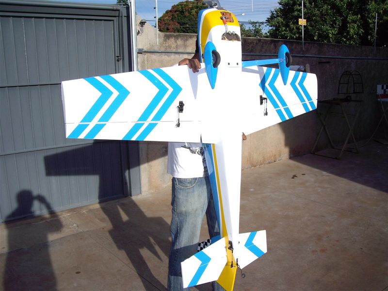

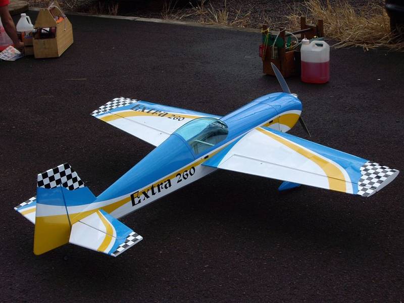

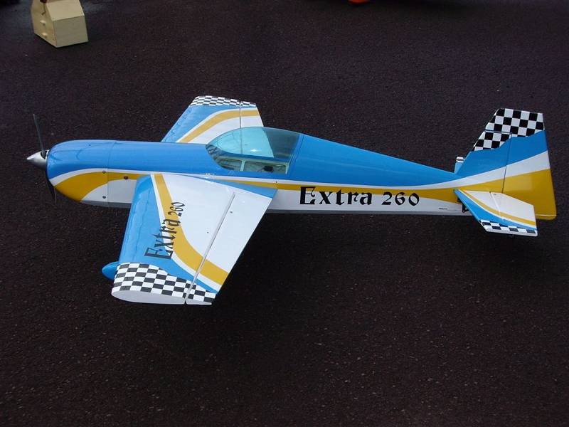

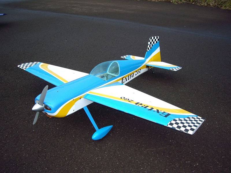

SOME PICTURES:

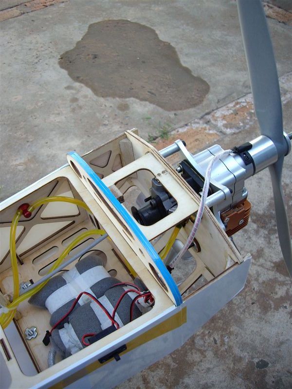

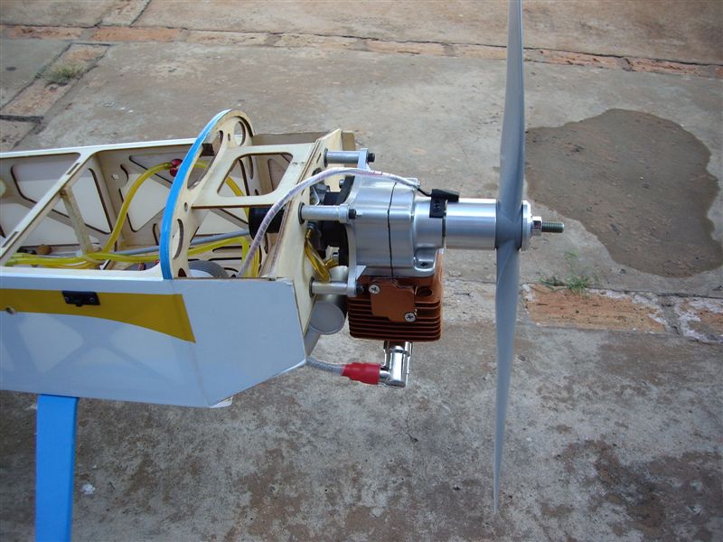

Jose the manual does not give the spacing from the firewall to the thrust washer. What is your set at and what size spinner did you use? So far this plane is unbeleivable. Its strong but really light for its size. I have not even got to fly mine and i already love it.
Old 04-27-2007 | 10:30 PM
My Feedback: (23)
Joined: Jan 2005
Posts: 52
From: campo grandemato grossodo sul, BRAZIL
Default RE: Peakmodel Extra 260 25%
As i sold the plane to a friend from another city, i can not measure for you now,. but i am posting some pictures of the en gine instalation.
I made some stands that were 1 1/2'' long.

Jose:
How do you access the carburetor for priming?, since the peak 26 does not have choke. Can you reach it from inside, removing the canopy ?

Yes, removing the canopy i could prime the engine for the first flight of the day, than i had no need to prime the engine, it always started in the first flip.
In my 260 i used home made standoffs, these were shorter than the peak stands, doing this i managed the prop shaft to have small gap to the cowling, and the carburator enterede more inside the fuselage, making possible for me to put the finger in the carburator for choking (for the first flight of the day).
