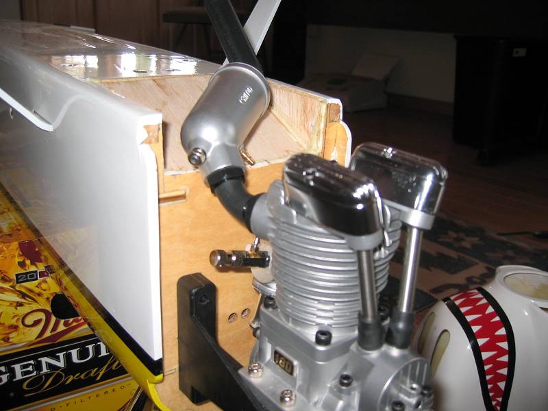

Does anyone have any pics of how they installed their Saito 180 on this plane? I Just installed one on mine and I had some clearance issues with the muffler. I moved the engine as far forward as I could and I pointed the mufler as far down as I could. I cannot imagine that I am not the only one to have this problem...so if anyone has done this differently let me know. I hate to second guess myself here but I figured it couldnt hurt to ask.

I'm just mounting mine. What I did was cut the central portion of the firewall and bottom sheeting out nearly up to the braces that run back the landing gear box then covered it over with a sloping piece of balsa. This also make an outlet for the cooling air. Hmmm Pic is worth a thousand words...
