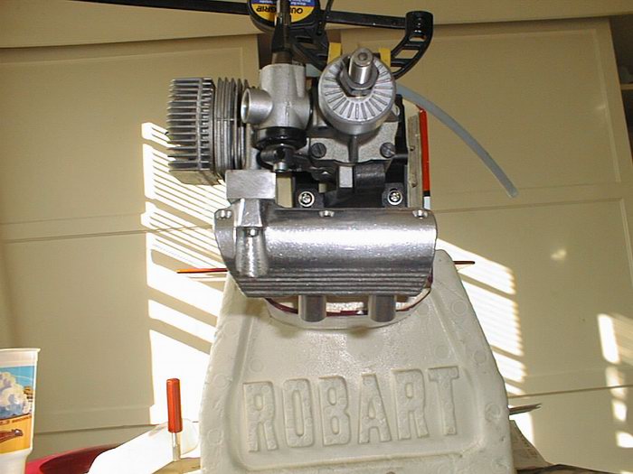

hi
i planning to use this engine too, but i already have super tigre 90.
should i use the tigre or the os?
anyone tried to use the slimline inverted pitts fot os 91fx 0r super tigre90?

Tooly,
Good question on the muffler. Will it fit inside? That sure would look nice.

we use the slimline pitts on a 91fx but mounted side ways , needs to run fairly rich for good alround response.

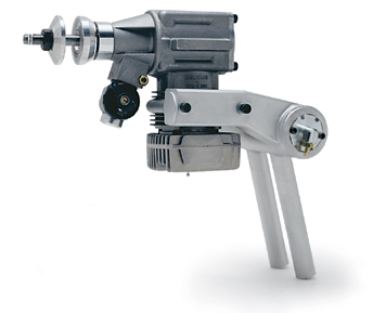

For what its worth I LOVE supertigre .90's but the pitts mufflers out there kill them ie needing a richer setting Ive found the Jtec muffler with an adapter is an AWEsome combo pulls my dago on a 12 X12 124 MPH WOW
