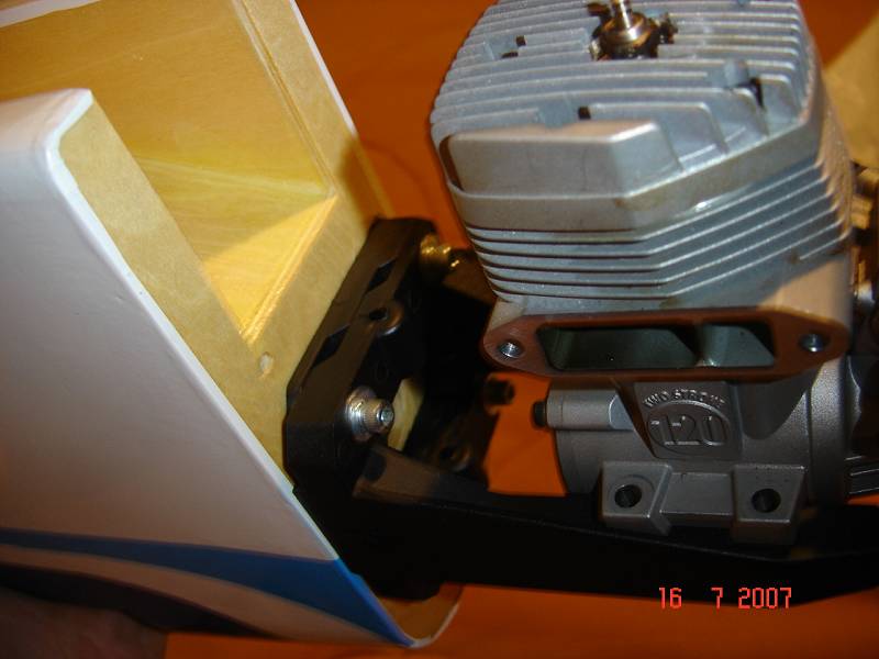

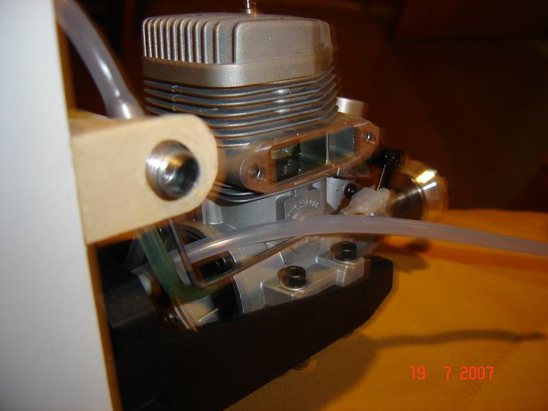

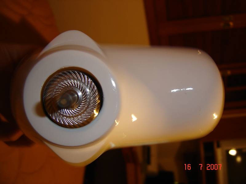

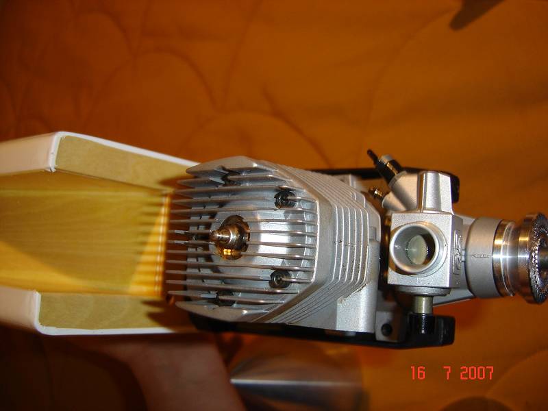

Well, well, well... Good news.
My U-Can-Do arrived today and I had a good surprise with it. It's a good plane. Very ligth and well done. I have a bad conception of planes from Great Planes for 3D flying, but this one is really good.
So, I am starting my project U-CAN-DO 60 + O.S. 120 AX now.
The 120 AX fits nicely in this plane. I have yet 1 or 2 mm on each side of firewall and this is good. I was thinkig to give up of 120 AX and install my 160 FX on this plane. Just kidding!!!!!!
Here comes some pics of 120 of firewall. I will post here pics of my project step by step for who to interest.
Thank you guys.
Eduardo

Whats the weight? If you get it less thean 8.5, you should be able to hover all day & have good pull out.

The U CAN DO 3D 60 + OS120AX should be a very goog combo. I run mine DO with a Saito 125 which also is a very good and lightweighted engine for this plane.

My UCD with mighty 110 is 7lbs 12ozs. My guess is you'll be slightly heavier than that. But 8.5lbs sould be easily done.
Good luck.

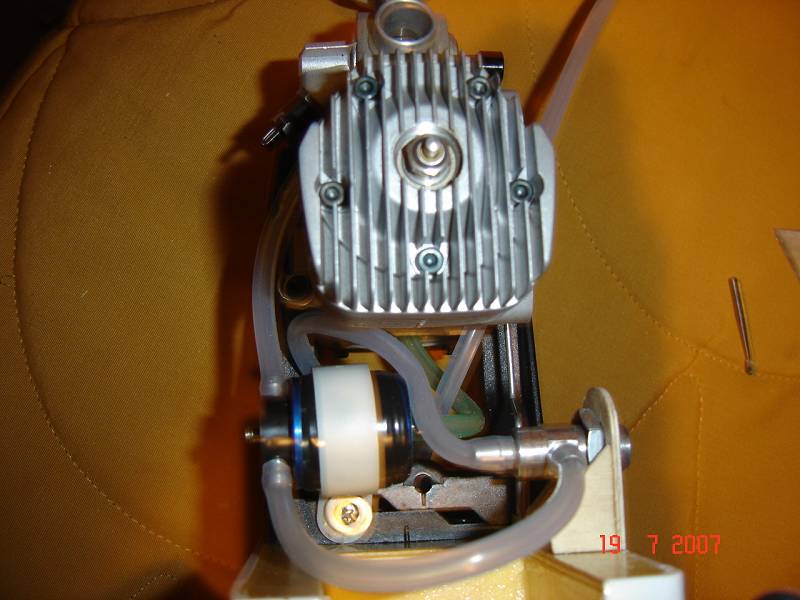

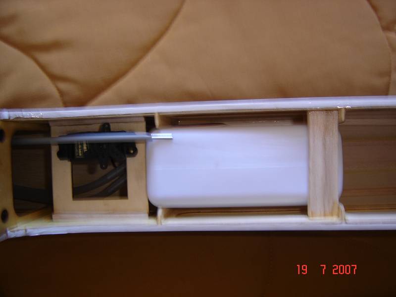

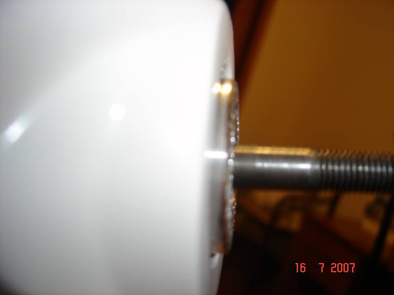

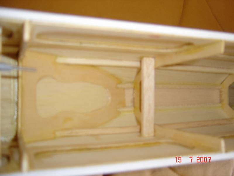

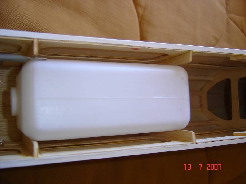

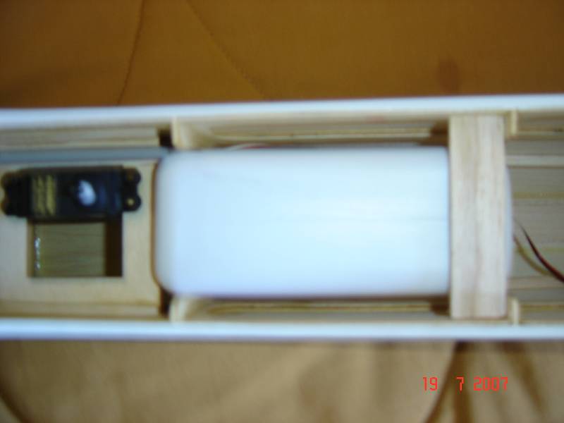

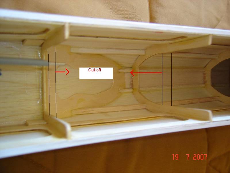

Here is my engine, fuel tank, throttle linkage and pump work.
I cuted off the horizontal wood of this parts of fuselage (see the pics. I don't know tha name of this parts in english) to install the tank.
Everything is fine in the end, I think. This plane is more easy to install the tank on CG than Funtana X, even with this thin fuse.
Tell me what you think, guys.
Thanks.
Eduardo

Looks tight but very neat & efficient. I have my fuel tank in exactly the same spot, right on CG which works well, I mounted a small HS81 mini servo for throttle under the nose of the plane,( the sloped part), the push rod is only about 4 ", just one or 2 bends to clear engine/muffler. I have been mounting the wing saddle tape on the wing rather than the saddle area, it seems to stay on forever this way, I do have to cut covering from the wing but its easy with a soldering iron. Enjoy the Do, report back on the maiden.

Hi MIXMASTER. Thank you for the nice words. I was thinking to install my throttle servo in the same place like you said, but my engine is more heavy, so I forgot it.
Please, if you can, post some pics of your Do config. It should be very good!!!
