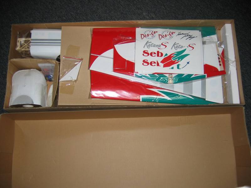

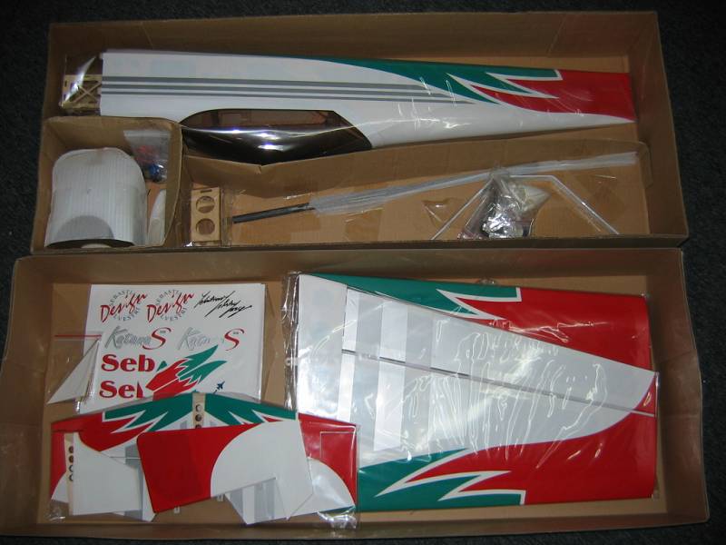

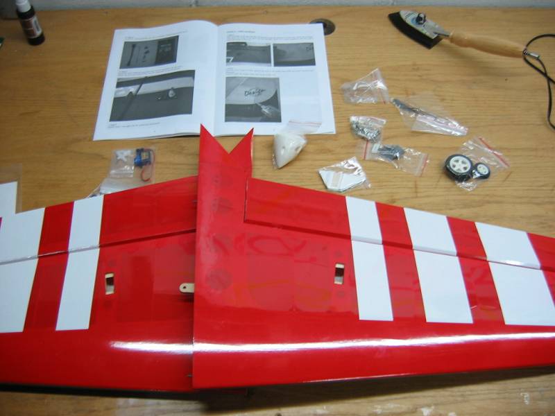

It arrives well packed in a thick cardboard outter box. Inside you will find a well packed airplane that arrives safe and sound.
The packing job was outstanding really.. right down to the fact that even the white painted landing gear was nicely wrapped to avoid any chipping should something get loose in shipping. Everything is securely taped so you shouldnt have any problems with anything moving.
Here are some pics...

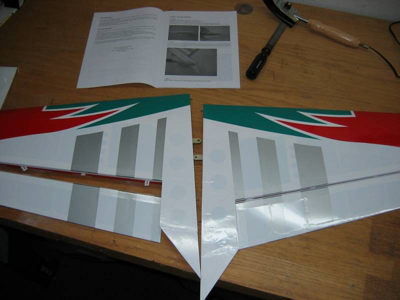

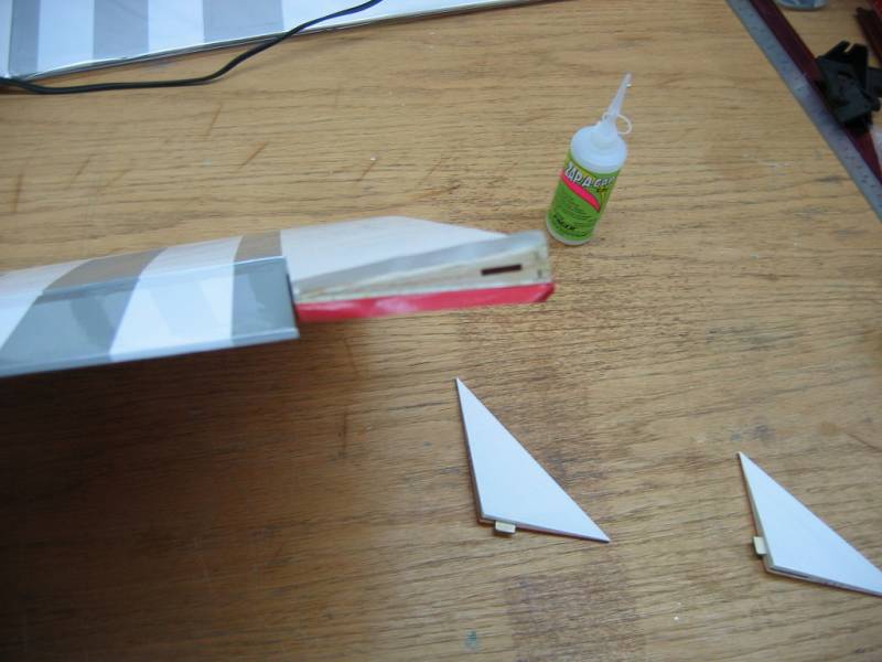

First is adding the wing fillets to complete the wings... after you use Medium CA to join the fillet to the wing you have to use an iron to seal the covering. It specfies medium heat.. make sure you use it! The covering is very sensitive to heat.

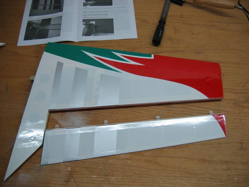

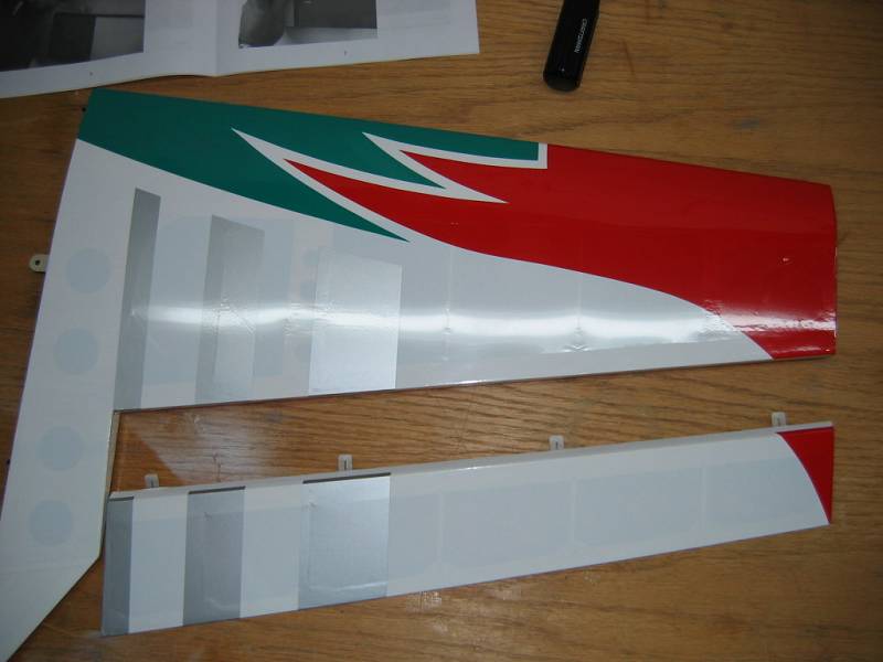

Next is hinging the alerons.. typical CA style hinges.. center them and glue one side in, then the join them.
Make sure you use small drops of thin CA so it doesnt run onto the covering... take your time. I did 2 drops from the front and 2 from behind..
This will wrap up for tonight...

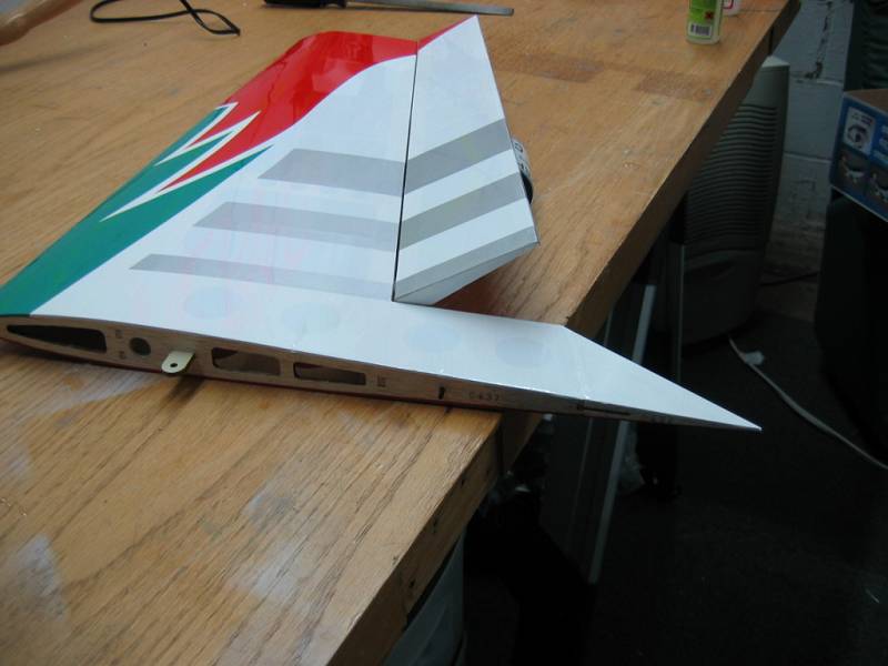

Next you need to cut open the holes for the servos in the wings.
I did the old trick of using a hot sodering iron.

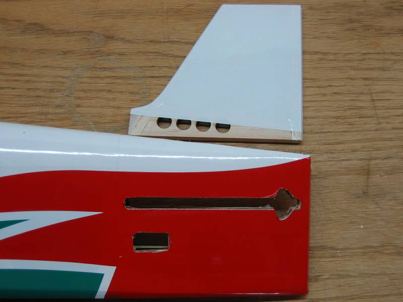

Next we will prepare to mount the verticle stab and rudder...
use your sodering iron again and open up the holes in the fuse. The stab mount is already trim and slides in perfectly. Double check your alignment and glue it in. I put a bit of medium ZAP around it and then once it was inplace and aligned just a couple of drops of thin. Doesn't need too much, will just increase the weight... this is a small plane.. little CA will do ya
Next just CA the hinges to the rudder side and let them dry. Put the rudder on the verticle stab and use some CA again to attach the hinges to the stab. Make sure you rock the rudder back and forth to ensure proper throw.

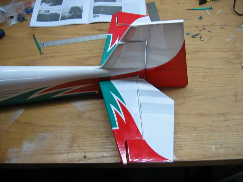

Now look at your elevator and check your throws and make sure there is no binding of the counterbalances.
Get your hinges aligned properly and use a couple drops of thin CA and glue the hinges in the stab ONLY
Then slide your elevator into the fuse and postion it all the way back allowing the stab to be put into place. For now put the hinges in the stab, do not glue them yet. Then slide in the CF wingtube so that you have a frame of reference to align the stabs. Make sure the stab is perfectly level with the wing tube and use a pit of CA to glue it into place. Lastly use some more thin CA to attach the elevator hinges.
