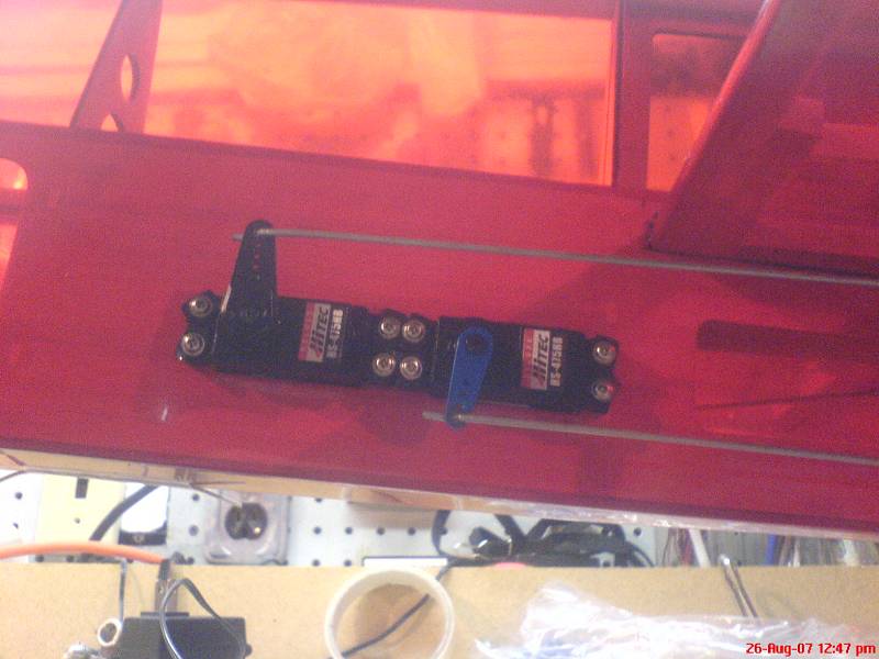

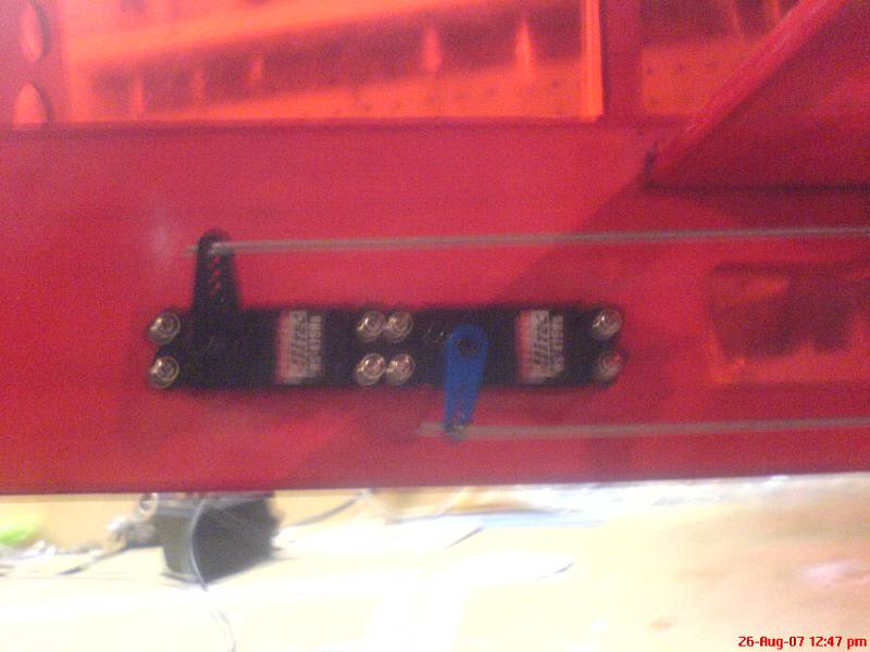

channel 6 is for ailerons so the flap knob will be trimming it. you need to use the gear channel whatever that may be on your radio.
or do this with a normal y harness
you can see that the elevator servos have the pushrods coming off opposite sides. on off the top and one off the bottom. the geometry is weird but surface travel is the same on both sides. and this saves money from a reversing y harness.
