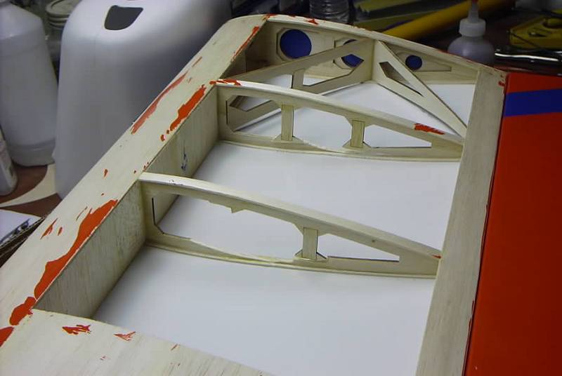

Well, I've wanted one of these since I first saw it online. I finally found a slightly damaged one on eBAY and invested $60. on it.
Other than 3 crushed ribs, (easily repaired) and a little replacement covering the Tango should be as good as new.
I'm curious about comments made regarding the planes performance. I would think that a smaller airframe like this would be a "hack" flyer...something to toss into the trunk and have fun with...not serious aerobatics and the like.
It's nice to have something inexpensive, fairly nice looking and easy to whip around other than more sophisticated designs involving more inve$tment. I can live with all the neg's mentioned as I have other aircraft that DO perform the way I want them to. Expectations there are naturally, quite different.
I see the Tango for what I can get from it, (fun) not what the marketing department at Hanger 9 might extol it to be. Guess that would be nice though, huh?
I usually tinker, modify, adapt and recover ARF's...but not this one. I was looking for a fun plane and I think I've found it. I'll let y'all know.

PM

Hey Pt Mugu, the wife got me a Tango and a second OS .55AX for Christmas, so it will be in my column soon. I plan on wringing it out and also fixing the roll due to rudder.
Before that I have a JBA .56 and a Goldberg Wild Stik that I just started flying.
I also just finished an Ultra Stick 60/SK 90 to replace the one I snapped the whole tail off of. It wasn't pretty. Came down on hard surface and splattered. All I could do was throttle back and watch.
This weekend I'll be testing a Lanier Stinger 40/Saito .72. The Stinger was only $80 at Tower-too good to pass up. I think it'll need bigger ailerons-3/4" is pretty small.

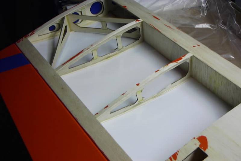

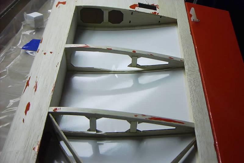

I'm still finishing up my Super Stinker but took a few moments this evening to actually look at the damage to the wing on my Tango.
I shook the wing and heard too much rattle-rattle so I peeled the bottom covering off. Hmmm. Not much in the way of woodwork here, LOL.
Here's a few photos. rather than attempt to recut exact replacements, I'm simply going to patch the existing ribs, apply some bracing to them and recover in white.
I got a great deal on 1 meter rolls of brilliant white from Sig. I like Ultracote as my primary covering choice but Aerokote is a very close second!
What do you think about an OS FS40 on this bird? I realize it a smaller displacement but speed here for me isn't as important as torque. I still have that new 50 2-stroker I mentioned before but a 4-banger sure is tempting.
Here's what that wing looks like inside:

That is light construction, but the plane is made to fly. Personally, I couldn't build one that light from scratch.
The 40 4-stroke would fly it around more like a fat wing trainer or a sport plane. A .56 would be better. For 3D type flying, you'd need something in the .70-.75 range. I had a Saito .72 and an OS .70 available, but didn't want to take the trouble to re-route the thrlttle cable. Besides, the wife got me the OS .55 along with the Tango so I was obligated to ues it. The .70 is now in a Stinger 40 ARF. $80 on sale from Tower. I didn't need it, but it was too cheap to pass up.
One problem with the .40 FS, or even a Saito .56, is nose weight. You might need the battery way up front under, or over, the tank. With a small engine, I definitely hate to add dead weight. I'm using metal gear, digital servos in the rear, but for a light engine, I think I would go with nylon gear standards. You ought to be able to save an ounce or so right there. This would probably translate to 4 ounces in front.
The old OS .40 never was a power house. I figure it would be like a .25 on the nose. I did solo a guy flying one on a 3-channel Sig Kadet Senior. It was slow, but it putt-putted around nicely. It was an old style trainer where you could release the sticks and the plane would automatically return to level flight. I saw him do it on final once when he got messed up in a right turn. I was about to snatch the transmitter when he released and bingo, the plane leveled out. He had turned left, then corrected wrong. He turned on around and went on and landed.
I'll bet one of the older Saito .65s would be nice and not overly powerful.
