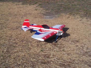

Default hey Pittspilot
I love the new OS 50SX i have on my Top Cap. Very strong engine!
