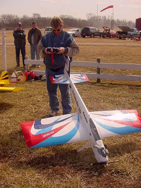

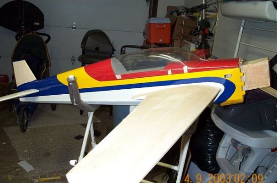

$60 to fix there screw up? Just do what I did hehehehe...
Old 04-11-2003 | 03:14 AM
Flyfalcons's Avatar
Posts: 6,544
From: Bonney Lake, WA
Default sato 100/U Can Do problems
What happened to the blue? That thing looks like a hopped up Camaro with a blower sticking out of the hood
I bought it from a friend who smashed it so I bought it and repaired it. The fuse was smashed and 9 of 12 wing ribs were broke.
I'll sell it if you wanna buy it! I had a Saito 120 in the nose and it was a little too heavy.

Originally posted by wgeffon
And, you liked it so much you sold the motor out of it.
Your getting to be as bad as Pugs.
It wasn't that fun with that heavy ass 120 in the nose... besides I got an Extra to finish up before June.
