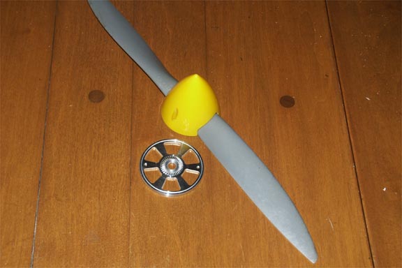

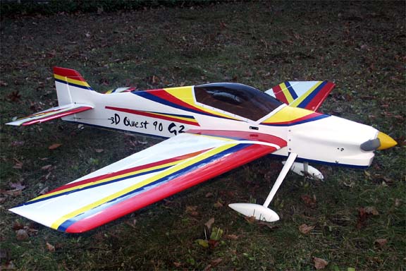

I use the Great Planes spinners mentioned in MicroDat's post on engines up to 1.60. They are light weight, they come in colors, require no special mounting hardware and are not expensive.
The pictures show a Great Planes spinner that I'm using on a YS 1.10 powered Quest 90 with an APC 16x6 prop. The larger spinners have 4 screws.

This is a good idea-your picture only shows two screws but that may be a smaller version. I really like using these. I take it you have no problems using this style on a 110 YS. Thanks for your input.

Yes, the spinner on the Quest 90 in the picture is a smaller size at 2 1/2 inches and has two screw holes. I use 3 1/4 inch diameter spinners on my OS 1.60 2-strokes and they have 4 screw holes. I have had absolutely no problems with any of them.
If you feel uncomfortable about widening the cutouts in the spinner cone to fit the prop you might want to look for a different spinner. I use a Black&Decker rotary tool to bench the spinner cone cutouts.
