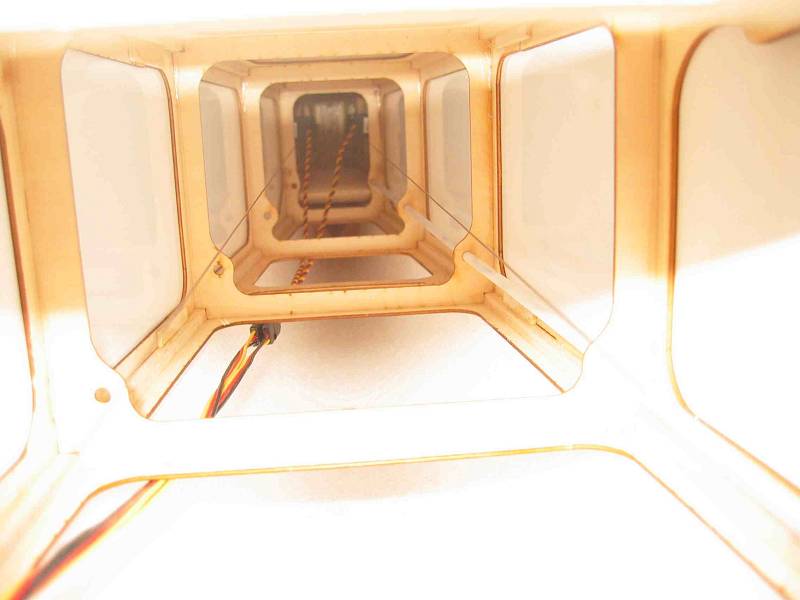

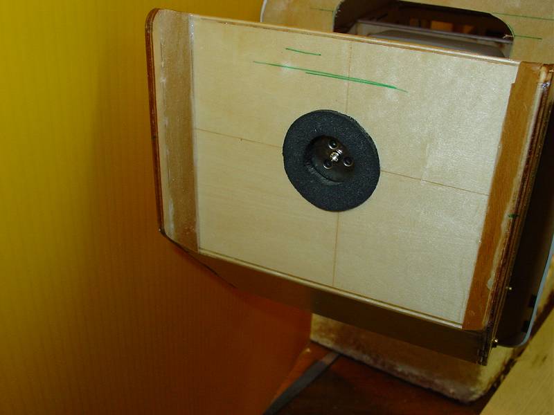

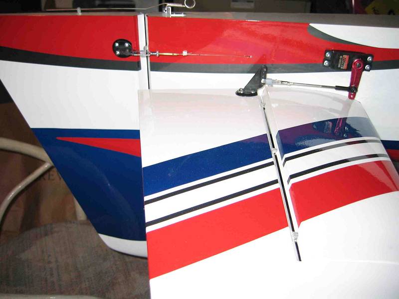

finished the cap today. 12.1 lbs stock hardware. os 160, pitts muffler, kline pump, fromco 2400 lipo w/regulator, 5945's on surfaces 5955 on rudder. one note when putting in the pull-pull the wires touched the elevator servos in the tail. I ended up putting swivel clevises that hung down on the servo arm to give me enough clearance. I already had the servo holes drilled out in the tail before I found this out or I would have sanded a little off the bottom of the servo cut-outs to give better clearance. I tried to take some pics of it. other than that the plane went together nicely. I ended up putting the fuel tank right behind the rudder tray which is on the cg. with this setup I was right on stock cg.

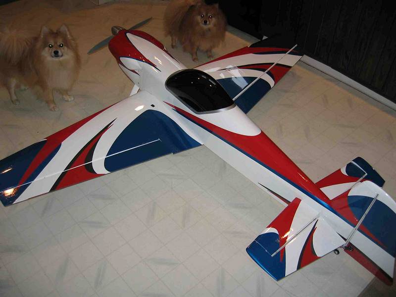

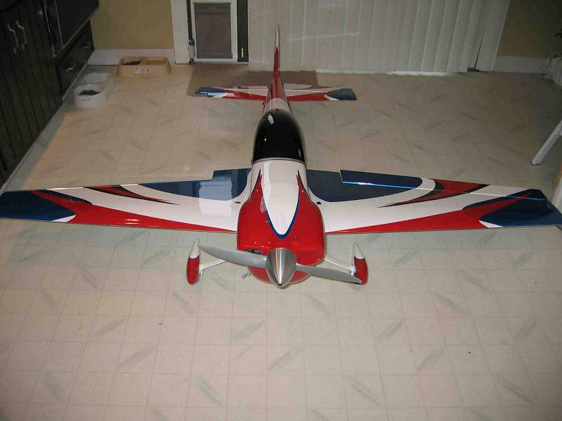

I just saw the post with a DA50 as the power on the front. Boy did that catch my attention! That is a lot of grunt for this plane. I must know how it workes out, please!!!!
I put an OS 1.60 with Bisson pitts muffler on the front of mine and it came out at 11 lb 11 oz.
The verticals are great and you could do two or three snaps in either and opposite direction, and just power on up afterwards (with an 18 x 8). I have two 8611A's on the elevators and one on the rudder. Very strong responses at low rates. No pump - moved the tank up behind the firewall. (Posted all of this stuff in the ARF forum. Didn't see it here till later.
