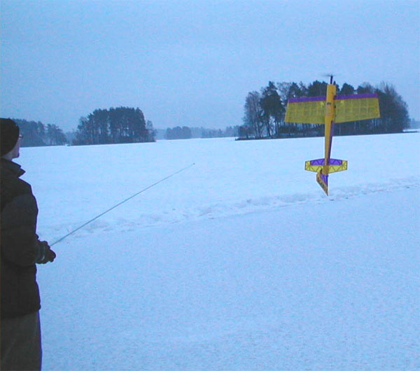

Diablotin Mini Super
Hacker B40 8L 4,4:1 14x7 on 10x2600
2:1 thrust weight ratio, 8min flights
people say it´s easy to hover...

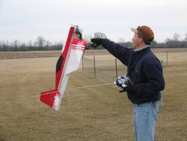

Here is my Morris Hobbies .40 Su-Do-Khoi, Its a pretty good 3D bird. Ricky

Looks like you ready to reach out and grab it!

Wayne - I think on one occasion I did reach out and grab it, But it was prior to the new rule change

Yeah I understand...
My Planes NEVER come closer than 25' to me and I would NEVER catch one out of a hover..
