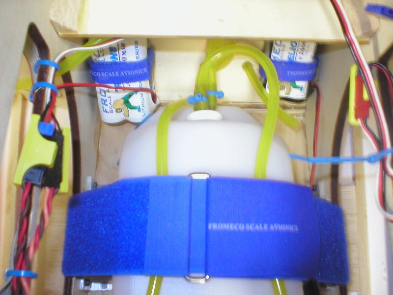

I can suggest a single elev set up.. just join the halves with a " [ " shaped wire or I ended up using a piece of carbon fiber tube.
As far as a fuel tank set up it all depends. I tried valves and regulators, but the only thing that seemed to work was lowering the tank outlet to be level with the carb slider. Some guys had no trouble at all.
Not sure about throttle servo... I used a HS 85 mg in the stock location.

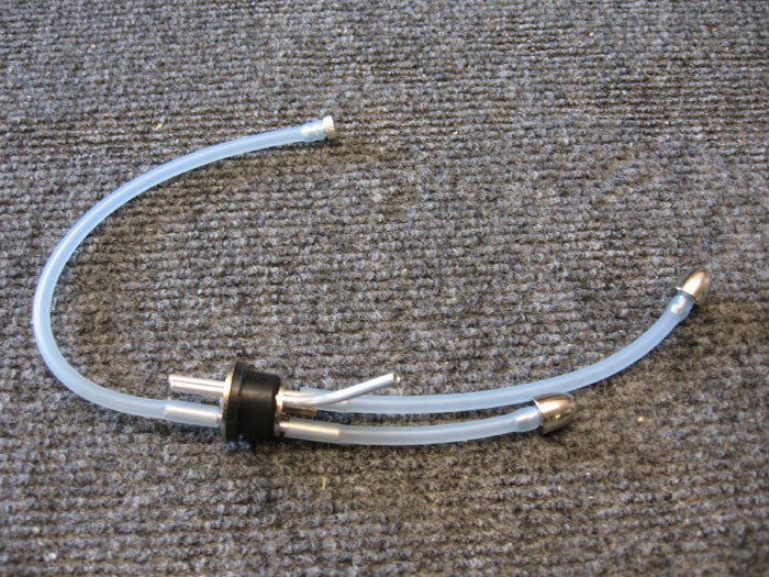

You do not need anything out of the ordinary. Just use a 3 line system.
One line goes from the clunk to the carb.
Second line goes from the second, shorter clunked line to the filler tube (capped with a fuel dot, this is where you fill the tank)
Third line is the vent line. This line loops is on the vent inside the tank. The fuel tubing outside the tank loops back to the top(back) of the tank and then back forward and out the bottom of the plane near the firewall. This allows the tank to vent, but fuel will not drain out of the tank in flight.
RE: Please Help on Building a Fliton Extra 330 Freestyle
Oh yeah, I forgot that the Saito 100 has a pressure tap on the muffler.
That is where the vent line from the tank connects. The exhaust pressure pressurizes the ful tank.
You can use a 2 line system and just put a Tee in the fuel supply line from the tank to the carburetor, but the fuel tends to pour out of the carb when you are filling unless you use a pair of hemostats to pinch the fuel line at the carb while youa re filling. The 3 line system is a much neater way to fuel the engine.

Mike, it seems your set up is more intended for a gasser. You don't need the loop. The line going from pick-up to carb will siphon possibly causing it to flood, or be hard to start. I never tried hemostats, the fuel lines were too hard to get to with the cowl on. On mine, the original tank outlet sat quite a bit above the carb slider, before I modified/lowered the tank mount.

No actually it ( the loop in the ventline) is intended for either gas or glow and it works well for both. In my comment I am talking about the vent line not the fuel pickup line. If the tank is vented to the air (not getting pressure from the exhaust) and the nose is pointed straight down the tank will drain out of the vent line everytime. The only way to stop it is to loop the vent line back to the rear of the tank so that when the plane is vertical the fuel wont drain out because the head in the vent line is higher than the head in the tank. Obviously if the fuel tank vent is connected to the exhaust vent fitting then the point is moot.
The 3 line clunk system works great for gas and glow models as well. You just have to put a fuel dot in the fueling line after you fill. It totally eliminates the problem with fuel running out of the carb when you fill, if it is a problem at all. I only use it when I cannot access the fuel line due to a cowling. When the engine is exposed, I just pull the fuel line off of the carb inlet, fill and then replace the fuel tubing.

I think i just thought of a simpler version. What about using a 2-line method, putting a T in the pressure line with a one-way valve before the T. That way you can fill it from there without worrying about the fuel going back into the muffler. The carb line would be untouched.

As long as you can vent the pressure off of the tank as you fill that would be great. Just watch the tank as you fill and make sure that it does not balloon up. There is a good chance that it will. Its a great idea, IF it works.

I totally agree Mike with the vent, but with the tank/clunk being higher than the carb, (which is how mine originally ended up with, inverted engine) the line from the tank to the carb will siphon, filling the carb with fuel. Once the flow starts it's hard to stop it unless you remove the source, or raise the carb line higher than the clunk. Like siphioning fuel out of a car gas tank. As long as the catch can is lower than the vehicle's gas tank, and you can get the fuel flowing, it will flow until you, remove the hose from the tank or raise the hose higher than the tank.
This was my experience with this plane, so I just thought I would share. Also it is my favorite plane to fly.
