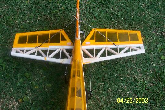

is it worth fitting them or not i am thinking about it cas a just glued my tail back on after a backward touch and go. the tail is as good as it was before just thought it might be a good idea. If you would fitt them what do you guys use wire, metail sheet etc my plane is a weston cougar

I just put some flying wires on my razzle, after the horizontal and vertical stab snapped. I used 4-40 threaded rods with steal clevises, cut of the clevis part with the small plug, drilled a whole out, and used 4-40 hardware to bolt it on. You will have to reinforce the area you connect the wires to with ply. I used a 1/4 inch dowel and drilled a hole in it for the hardware. Here is a photo.

i was thinking of doing it like that only with wire did you notice any change in flight?

Not at all. Now that I installed the wires, I can do a lot more aggresive maneuvers without haveing to worry about the stab snapping or breaking. It in no way changes the flight performance. It will add a little tail weight, but I needed it on my razzle for the 3d I am doing. Hope this helps. Justin.

i dont think the cougar needs flying wires from what ive seen, just make sure the tailplane has a good seating and glue it well, the carbon fin wont snap,but make sure that is glued in well .
