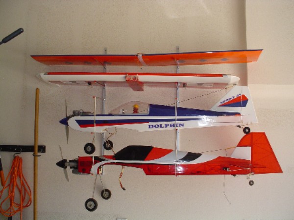

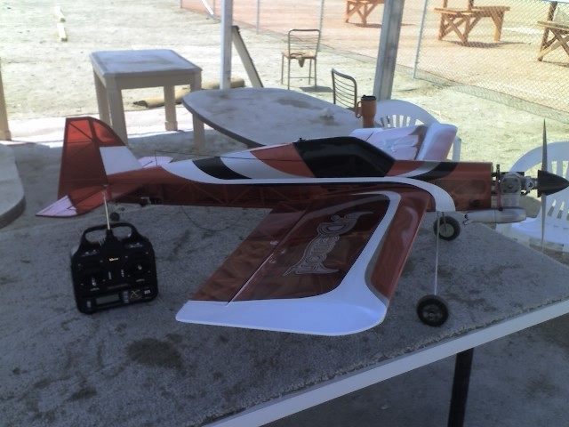

The 3Demon does great 3D work with the electric brushless. We have 4 of them in our club, 1 electric and 3 O.S .46. Mine has a O.S. .46 AX, the vertical is out of sight and with a little power it will hang on its nose. I'm not very good with the 3D, about 5 seconds is all I can do. The 3Demon will fly as wild or as tame you would want. Landings are a breeze with its slow speed. This plane is a keeper.
