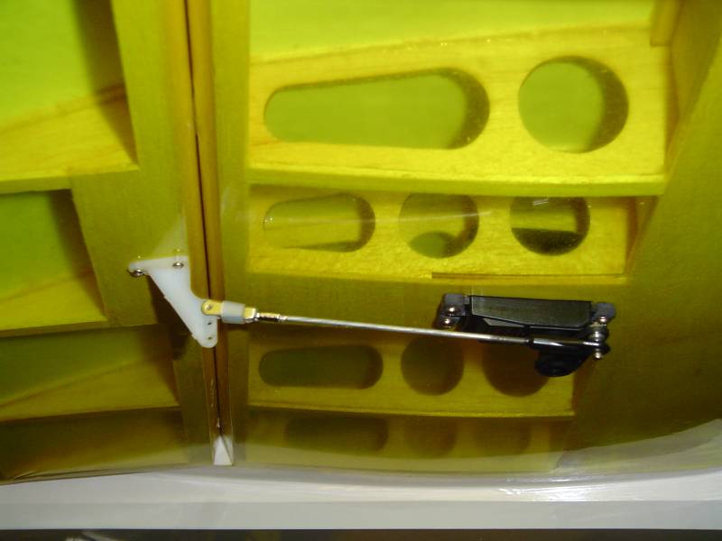

Here's a few pics of a Funtana 40 I had. I do all of mine like this. Anything bigger then this is the same set up but with 4/40 stuff. The arms are from Du-bro on the servos. The ball links are Sullivan I think.
David
David
Are those clips soldered on?
