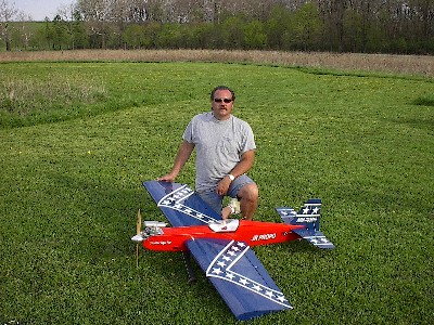

Also have the the 3D Freedom awesom plane, I have a TT Pro 120 on mine and it flys it great mostly need to fly it at half throttle hovers nice and plenty of vertical.
better pic. of it on my web site
http://www.geocities.com/ritchie_rich_1999
