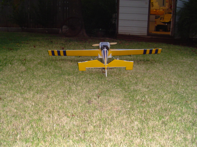

I've been reading a lot about mixes and I'm a little confused on how it should work. What is the correct way to set up this mix:
Elevator up _/ flaps up __/
Elevator up _/ flaps down -\
im pretty sure thats the way to get even tighter loops

The other way is called spoileron. It can be seen in the pic below.
David

what do spoilerons do, qs show in daveopam's pics

Take the time to read through several "Set-Up" forums generally in the pattern forums and try to commit to memory. Usilng spoileron generally will help wih 3D-elevators-reduces wing rock. You will pay a price for some mixes in speed (drag) but some trad-offs may be worth it in lap times. Example pictured is on the extreem 3D side, you dont need much to help turning sharply. Start with a little, 5-10% and experiment. Every bird is a little different. ENJOY

That mix is used for some extreme moves. It does help with wing rock but that's not what I use it for. That mix will let the plane fall straight down in an Elevator. I also use it for Waterfalls and Walls. On a down wind Wall the plane will stand straight up and slide forward 20' before it stops. Same way on a Parachute. A word of caution on this mix. The plane flys terrible with the mix on. For that reason I use the trainer switch on the radio to turn the mix on/off. I have tried it on a regular switch and it almost cost me the plane at the bottom of an inverted Elevator.
