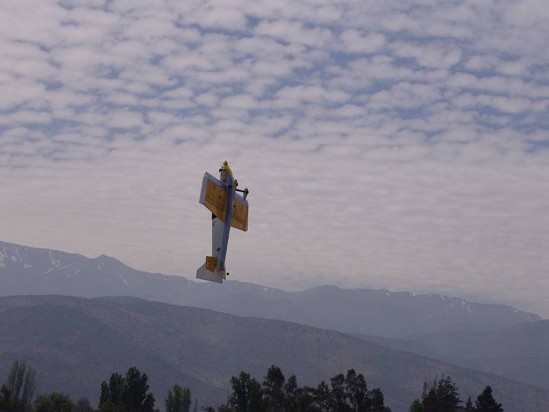

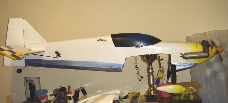

I can speak for the funky, it is a good plane, but it sure does not fly like profile, I had to add all the purple area in the belly to make it KE like I want, but with this mod it can ke loop and high alpha KE (needs some mixing), torque rolls easy, harriers better inverted, flat spins inverted not upright, has unlimited vertical with a os46fx with tower mufler (2,1kg) but I use hs81MG servos all around exept for the rudder on 6v with a 4602s lipo and a 3 Amp regulator to make it lighter.
Sure the yak can be easier to 3d, but as I have heard if you want a profile to build the MOJO is very popular

Hello Daniel, In your video, the "purple area in the belly" you mentioned is barely visible, could you please show me a close up of your fuse just to have a good image of that modification ?

This is the fuse mod, also, I have not used the wingtips, they produce more wing rock
