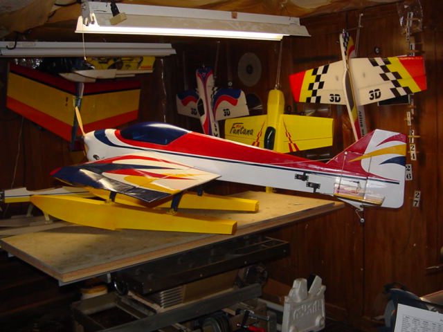

A mod I have made is the landing gear. I fly from a rough field and changed gear to the Dubro plastic gear. Also, I went to 1/4-20 nylon bolts instead of the 6-32 bolts supplied with the kit. I had to install 1/4-20 T-nuts also. This mod lets the bolts break and the gear come off without any damage to the fuselage.
Another mod is bracing the stab with wire. I fly a lot of manuevers that stress the stab because I have an O.S. .91 pumped 4C engine and floats that weigh 2 lbs.

Notice the Dubro gear which I use for floats and field.
