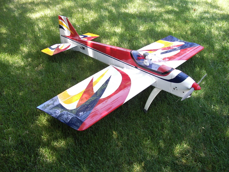

UCAN DO DEATH.[sm=what_smile.gif]
Well today the UCan do exploded in mid air in a dive dont dive your UCD to fast or the wing will fail and you will have a UCando Death.[X(]
But it was a fun plane but they allhave an expiration date.
before and after..poor snoopy i'm begining to think he is bad luck..

Sorry, linkadrip! Looks like my first UCANDO. It fell out of a hover started straight down and the left wing exploded. Flyying with half a wing was fun. I did get it leveled out inverted.......for about 10 secs.
