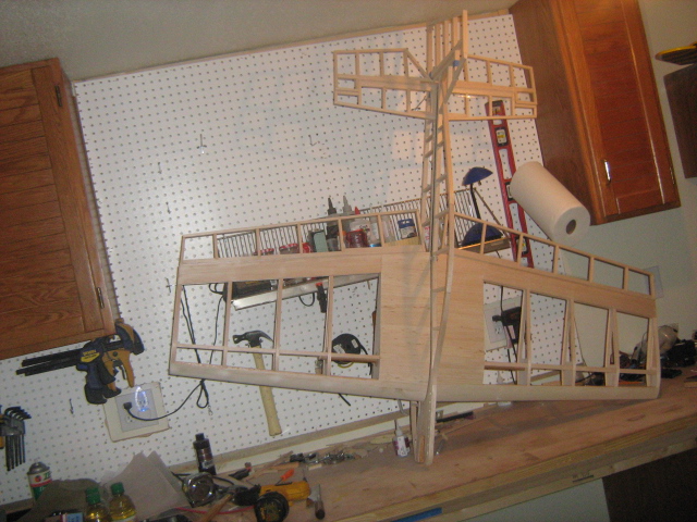

And speaking of that profile, I can only assume it's your MoJo....the subject of the ill-fated build thread.
How's it progressing? If you wanna sneak in a pic or two, I'm sure no one would object.
Erik,
I'm in the middle of 2 kit builds right now. The 80" Midwest Citabria and the Mojo 60. The Mojo is ready to cover and finish, but I'm short on $$ for the motor (SK90 2 stroke) and I am pushing to get the Citabria done in time for a big show in late January. I have all the parts to finish the Citabria now, so I'll be concentrating on that. I'm considering entering the Citabria in a "Beginners" class of a local building contest. I'll probably finish the Mojo this winter and fly it in the spring.
