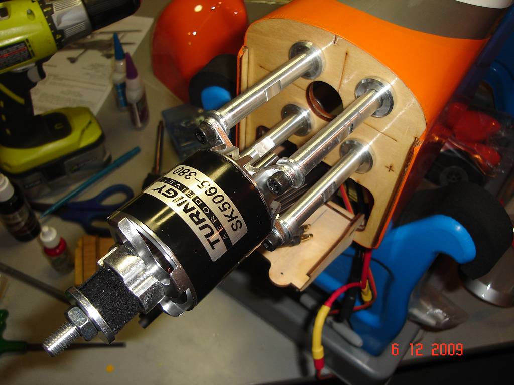

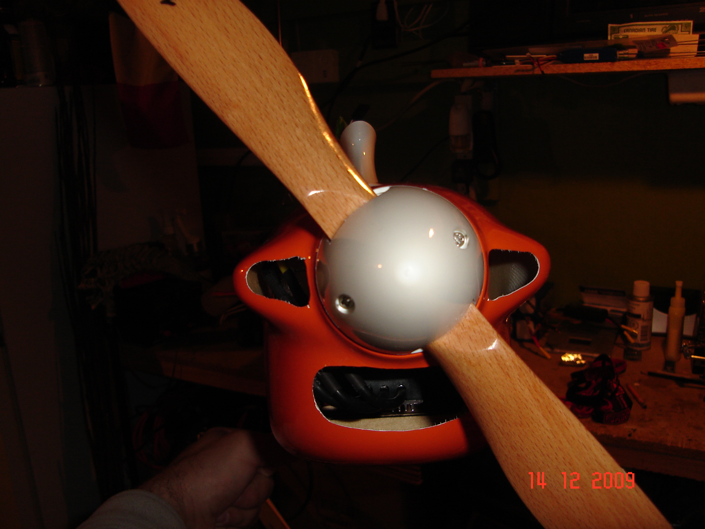

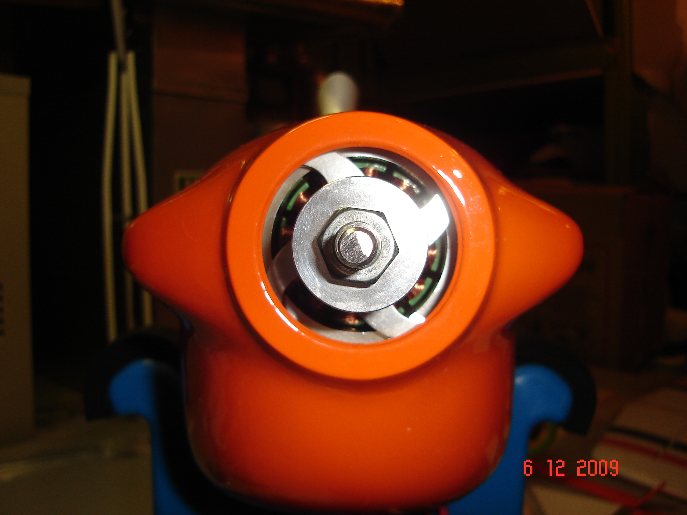

Got my Reactor Bipe all done this weekend.
I did it as an electric setup. So far it worked out good. Have not had a chance to maiden it yet. Work has been busy and with the holidays fast approaching, other things are taking priority.
I used some relatively inexpensive components from Hobby King for this.
The motor is Turnigy SK 50-65-380. Similar to the Rimfire 80 but less Kv. So I will have to use a bigger prop than the manual suggests.
ESC Is a new Turnigy 85 amp
Batteries are 6S 5000mah 20c
I ended up using some aluminum stand offs I had laying around to mount the motor. They just happened to be the perfect length with this motor.
Here are a few pics of the motor install.

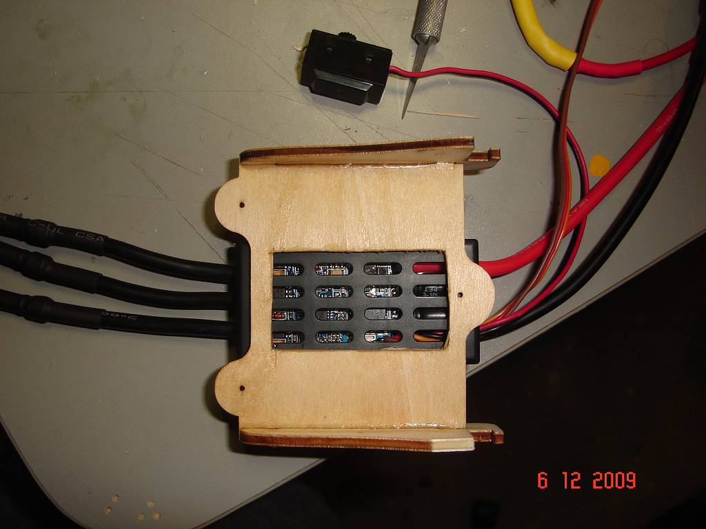

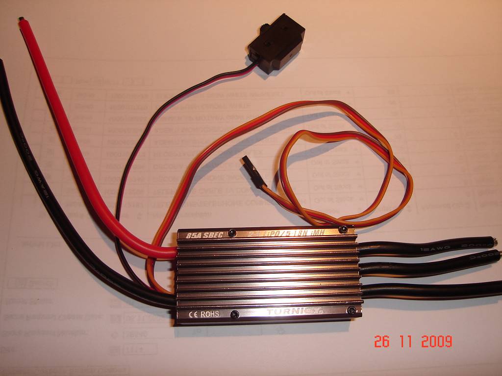

The ESC is an enclosed unit. It has a nice heat sink on the top with a plastic case. The bottom of the case is ventilated.
When I mounted it I cut out a hole in the ESC mount to take advantage of the case ventilation.

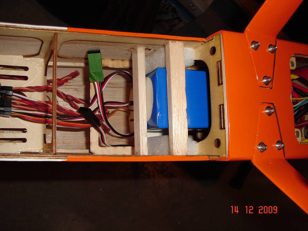

I had to modify the battery cradle slightly. The battery had to sit further back to get the correct CG.
The first photo shows the stock recomended location. But since I was using a bigger battery I had to slide it back.
The 2nd photos show how far back it had to go. The last photo is a cradle I made that the tail end of the battery slides into.
The forward half of the battery still sits on the original battery mount with velcro etc. It works good. I can get the battery in and out with the plane fully assembled without issue.

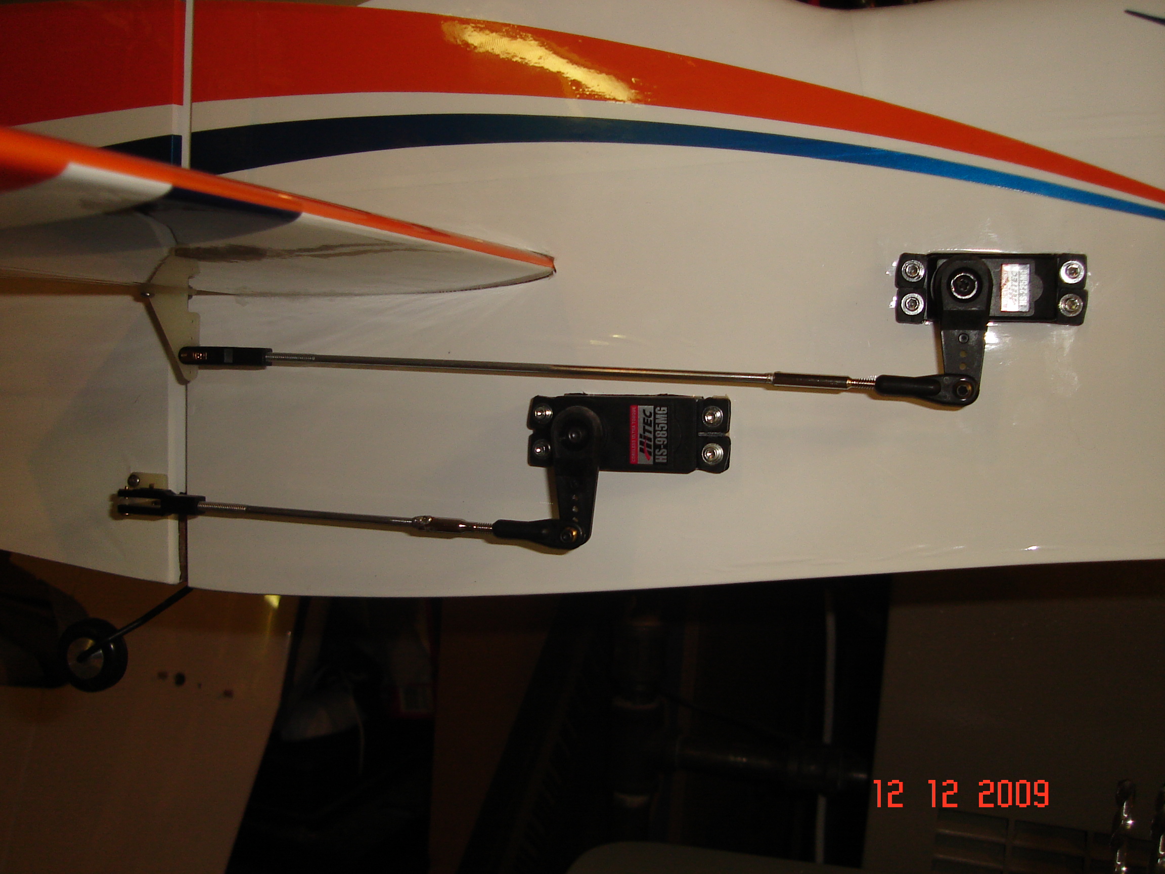

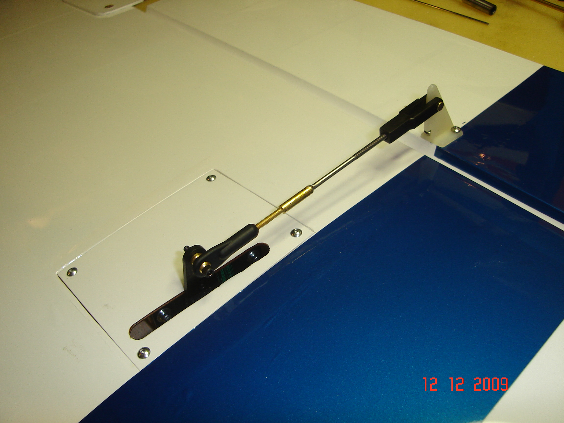

For servos I used Hitec 225's on the ailerons and 225MG's on the elevators.
For the rudder I used a Hitec 985. Overkill I know, but it was sitting there.
Linkages, I went with Dubro locking clevices and ball links just because thats what I like to use.
2/56 rod on the ailerons and 4-40 on the tail group

Here it is all done.
I have since added some decals, but I don't have the plane assembled at the moment for a photo.......
All up weight with the battery is 8 lbs 1 oz. A bit heavier than a Nitro install. But my wing loading is still 16.23 oz/sqft.
I plugged in the watts up meter for some readings.
With a 17x8 E-prop this is what I got.
1427 watts at 60 amps
Translates to 178 watts/lb
Digital fish scale tied to the tail gave me 12 lbs 7 ozs static thrust.
I have a 16x10 to try and see what kind of numbers that produces.
Overall I think it should fly nicely. Hover and pull out should also be good.

The battery was just luke warm coming out of the plane. If I get a chance next time and remember
, I will put a temp gun on everything as soon as I land.The hole in the fuse behind the wing could easily be covered with a piece of monocote or left closed until the spring when warmer weather comes.
The big opening at the front could be left smaller until the warmer weather rolls around. The opening on the bottom could be a bit smaller as well. But there should be some air flow through the cowl.
The motor and ESC staying cool is a good thing. But you do want the battery to warm up a bit, or it won't give you full power.
The temperature yesterday was around -2 C or 28 F at the first flight and about -7 C or 19 F by the 4 th flight 2 hrs later.
