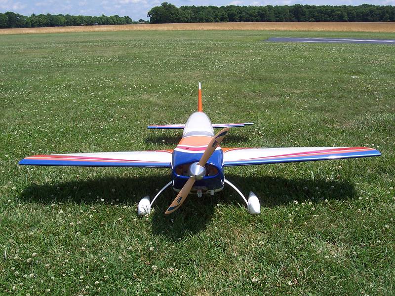

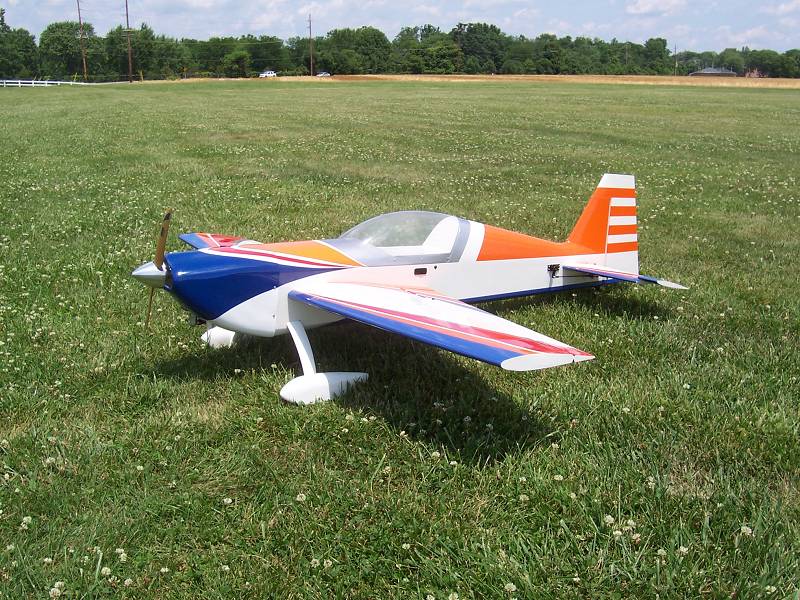

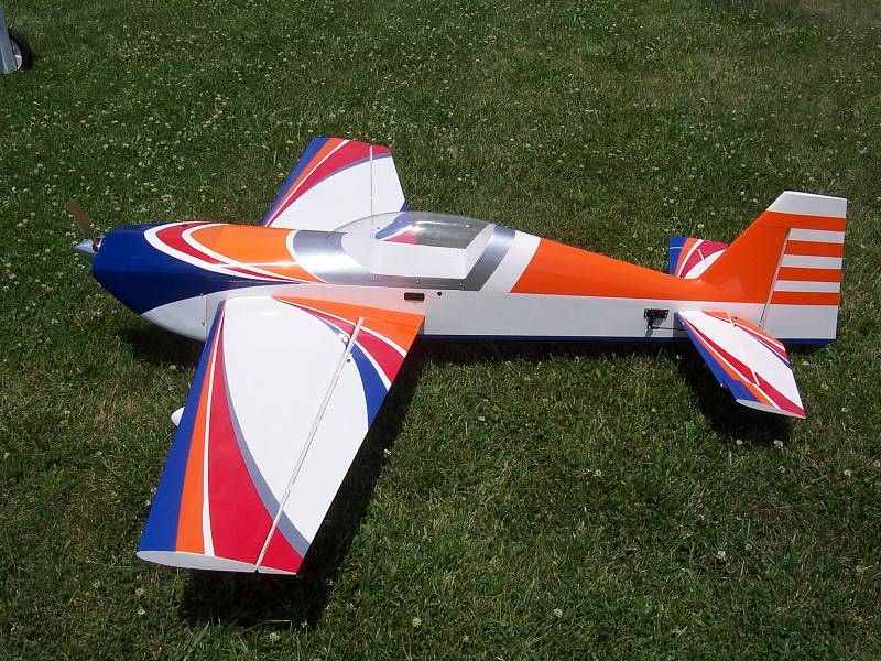

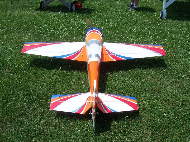

Here are some pics. Pre-maiden

Looks good! Sounds good too. I'll have to definitly consider this as my gasser plane. Do you think it's flying quality competes with a quality 50cc?
Old 07-13-2009 | 10:10 PM
  #62
Jimeni's Avatar
Joined: Sep 2006
Posts: 1,275
From: West Carrollton, OH
Default RE: Fliton Extra 330s 120C Build Thread
Maybe with some 50cc models, but as a rule, no it is not comparable.
