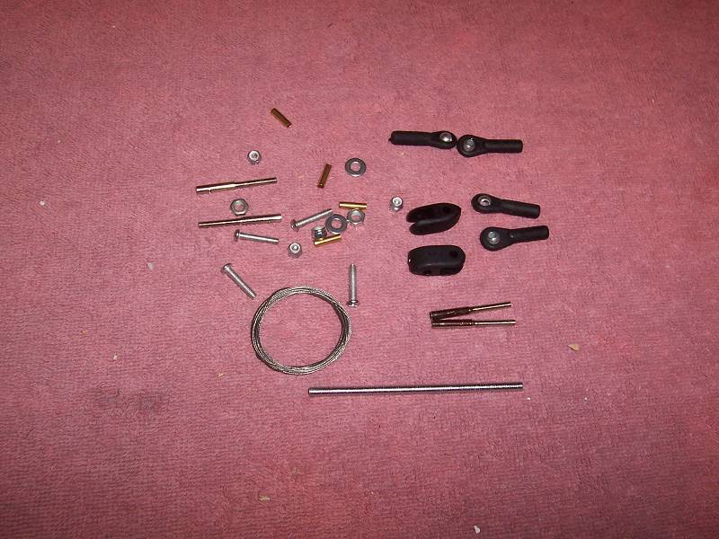

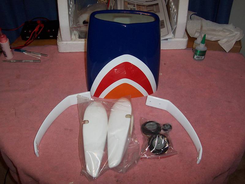

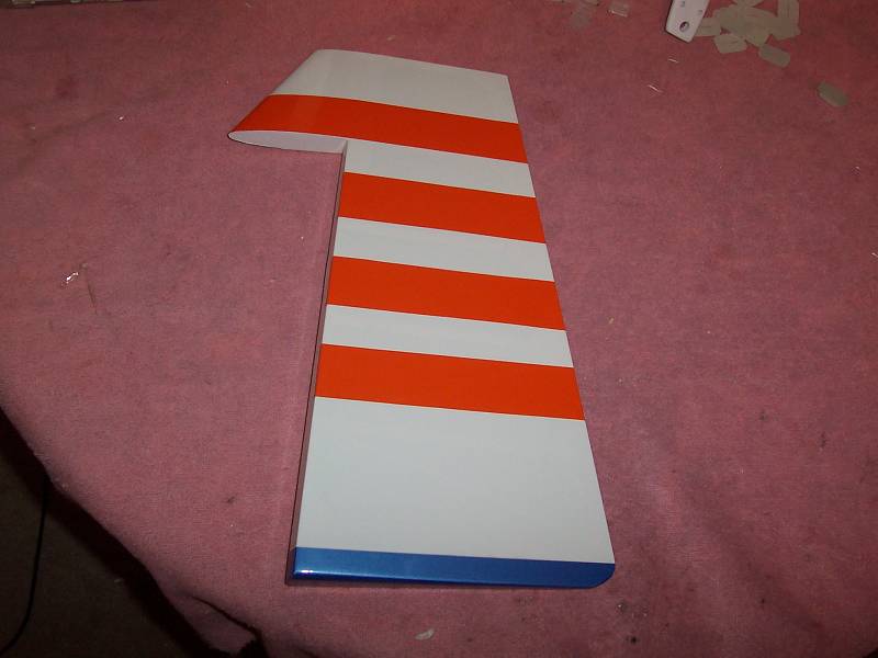

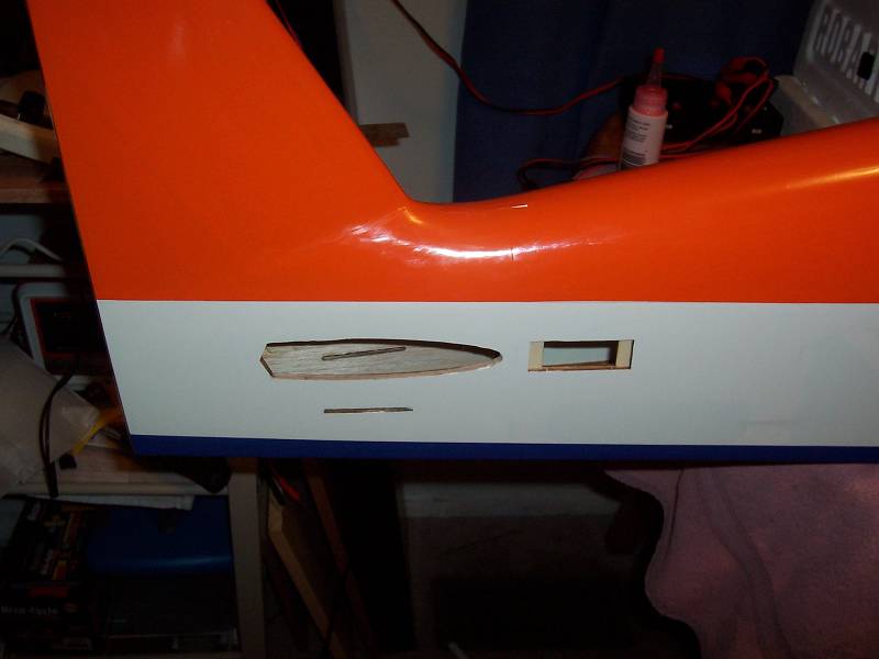

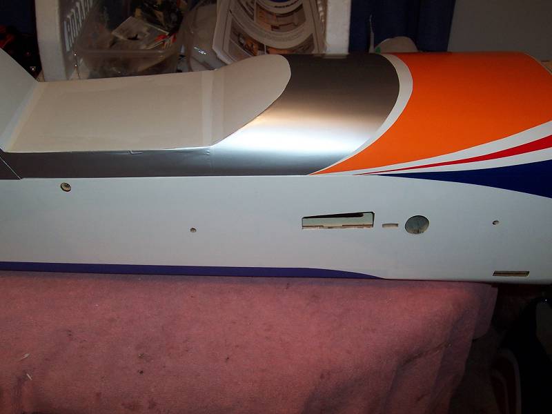

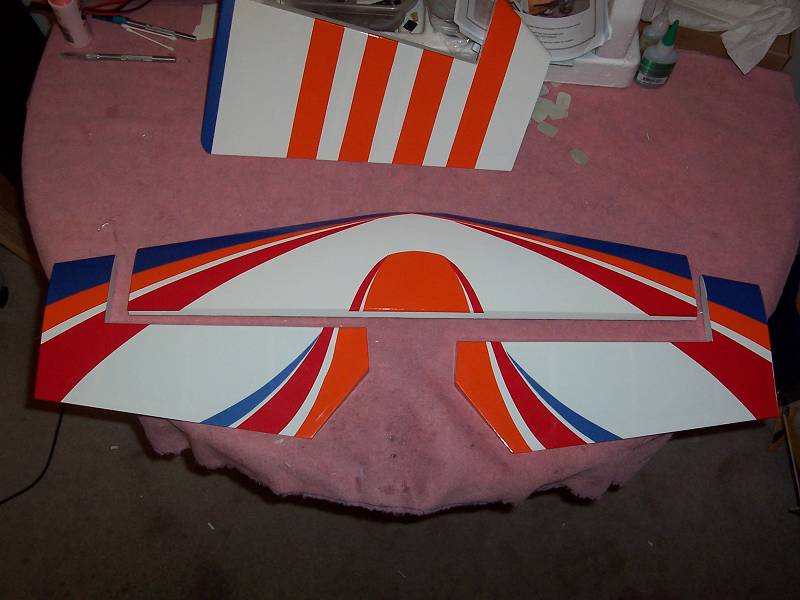

Just got my Fliton extra 330, starting a support, and build thread. The plane is very well built, and almost too pretty to fly, almost All of the hardware needed to build is provided in the ARF kit. I plan to use it all except the CA hinges. This plane is way too big for CA hinges, DONOT use them. I'm using Dubro flat nylon hinges. I personally dont care for the pull pull rigging couplers, so I am changing to Dubro 4-40's. The couplers supplied are fine though. Carbon fiber wing tube, and painted carbon fiber gear are provided. The horizontal stabilizer is a fixed style. You can get the plane here http://www.advantagehobby.com/produc...175&page=1Advantage is the USA distributor for Fliton.

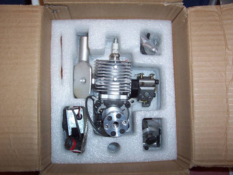

My set up is going to be:
MLD 28 cc gas engine. It is the engine shown in the manual and you can get it here.
http://www.cermark.com/products/MLD%...AS-ENGINE.html
Smartfly ignition regulator http://www.cermark.com/products/SMAR...Regulator.html
Smartfly optical ignition kill. http://www.cermark.com/products/SMAR...on-Cutoff.html
Vess 18x6 prop
Hitec HS 5625MG servo's all around, HS81 on throttle. http://www.hitecrcd.com/servos/list
7.4 volt 2200 mah lipo for RX with Duralite 6 volt regulator, and 7.4 volt 1300 mah lipo for ignition.
Tru turn 3" spinner.
Here are some pictures I have so far.

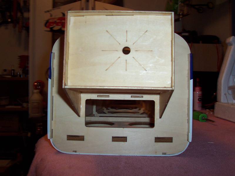

How does the landing gear carriage look on this? I know Fliton plane's have a reputation of weak landing gear mounts. In my Fliton AJ Extra I did a few stregthening mods and haven't had any issues.<div>
</div><div>Are you using dual elevator servos?</div>
Old 06-17-2009 | 09:17 PM
Jimeni's Avatar
Joined: Sep 2006
Posts: 1,275
From: West Carrollton, OH
Default RE: Fliton Extra 330s 120C Build Thread
Looks like a lite coat of epoxy will be enough reinforcement. I'm not going to add any wood.

Well Ilike the Extra best. I prefer a more scale like paint scheme, but this one will do.
One thing Iheard about the Cermark Extra is, if you want to use dual elevator servos, you need low profile servos as there is not enough room in the fuse for them across from each other. Will you be able to fit 2 full sized servos in the Fliton Extra across from each other for the elevator.
Another thing Ijust noticed, the markings and hole on the firewall appear off center. Are they?
<br type="_moz" />
Old 06-19-2009 | 06:18 AM
Jimeni's Avatar
Joined: Sep 2006
Posts: 1,275
I had not heard that about Cermark's extra. I just went and put the elevator servo's in this one, and there was an 1 1/2" at least between them.
The off set is to account for right thrust, if it were not that way, your spinner would be off center. I did not really pay any attention until you said something, the off set is a little more pronounced than some other models, but so is my 60" Fliton extra, and on it, the spinner is centered better than on some other models. But all the planes I've had are this way.

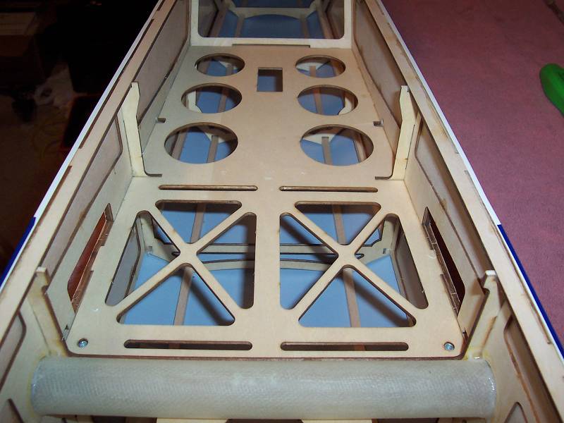

How much room is there in the underside of the fuselage? Is there room at all for a small canister, or is that pretty much out of the question? The small engine I've been looking at is going to have its own canister option as well. Just wondering if there would actually be any room to really squeeze one in this fuselage. I'll have to see if I can get the actual dimensions for the canister.
Also, how well does the paint job on the cowling match the covering. Does it match well, or are they a slight different shade. Its hard to tell from the pictures I've seen.

Not sure, never installed one myself. But this pic should help. Under the opening that is below the engine box, you can see 3 tabs. That is the floor to which the gear mounts. Not much room under that at all. If you could work through the opening, and go out aft of that, you might be ok. If you want specific measurements, let me know what you need.

The canister is 1.5" diameter and 5" long. So if you could fit something like that in, then there might be room.
