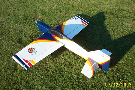

Here is a pic of my freestyle, I added the stripes to the wingtips to aid in seeing it on a white cloudy background and painted the canopy black, took the silver border off it and slide it back till the front edge was only 1/8 inch in front of the dash cutout. Cant seem to figure out how to get more than one pic up right now so this is it :P LOL

Just some adhesive backed trim strips from my local hobby shop, I saw they had all three colors in stock so just decided to go with it.
