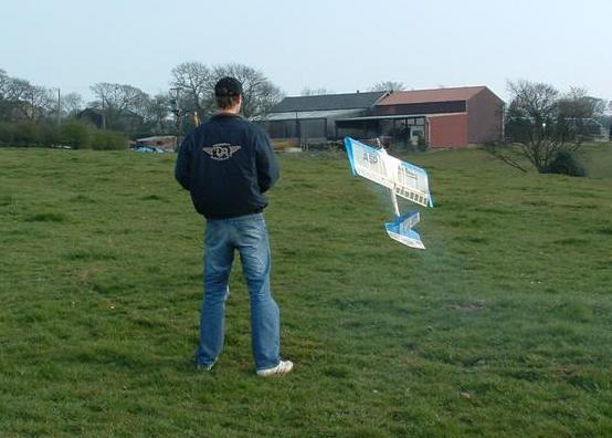

My limbo has also been highly modified, i weighs less than 2pounds. The elevator servo is under the tail for fast responce. It is powered by a ASP 36 and will PH at under 1/2 power on a 10x4" APC. The CG is about half the wing, which makes it superb for prophanging and spinning. Also excels at torque rolling.

AndrewR: how did you get it so light, im doing "project cougar bodge" at the moment. knowing how to do that lightening thing couldd be helpful.
