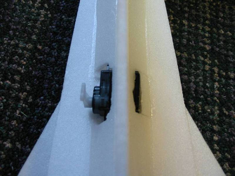

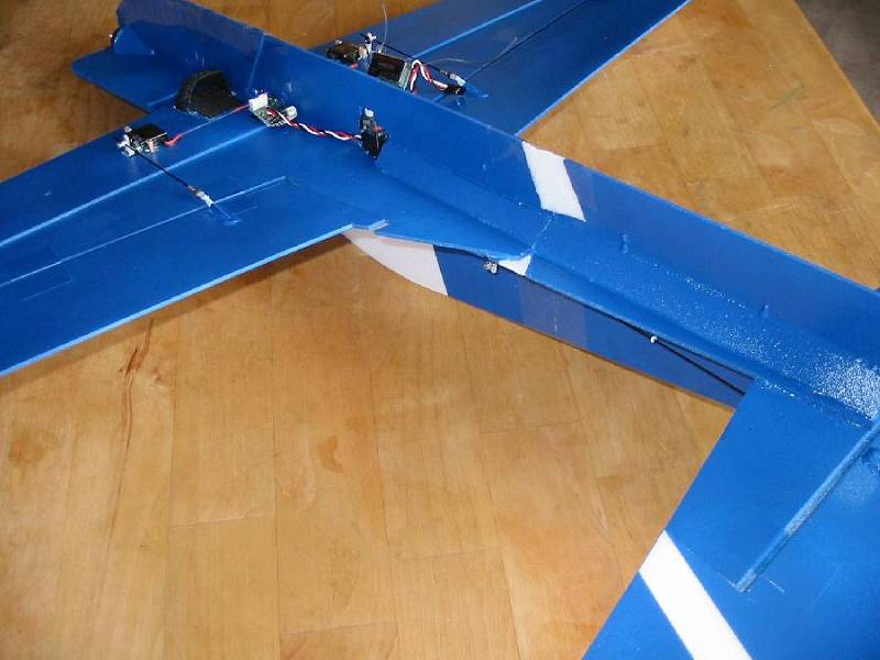

I have a couple more questions for you:
1. I'm trying to put the control horns together. Is the part I'm holding correct? What's the little piece for?
2. I can't figure out what the half-inch strips of depron are for. Where do they go?

Hi, it looks right, if you ca them in good you wont need the bottom piece farthest from the hole on there. The piece laying on your table is for a bipelane, but can be used for a pushrod guide. The strips are to box the tail of the plane for strength yet keeping it light.

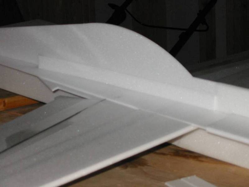

John, thanks for your responses.
I'm not sure what you mean by "box the tail." Down the side of the fuse, butting up against the fuse rail?

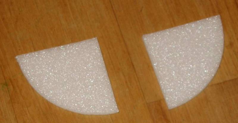

Also, where do the quarter circle pieces go?
Nathan

Nathan, the strips to at angles to box in the tail area from the wing to the elevators.. a 45* angle
The discs are just to keep the fuse and stab square to the fuse when you glue it together, they dont get glued onto the plane at all.

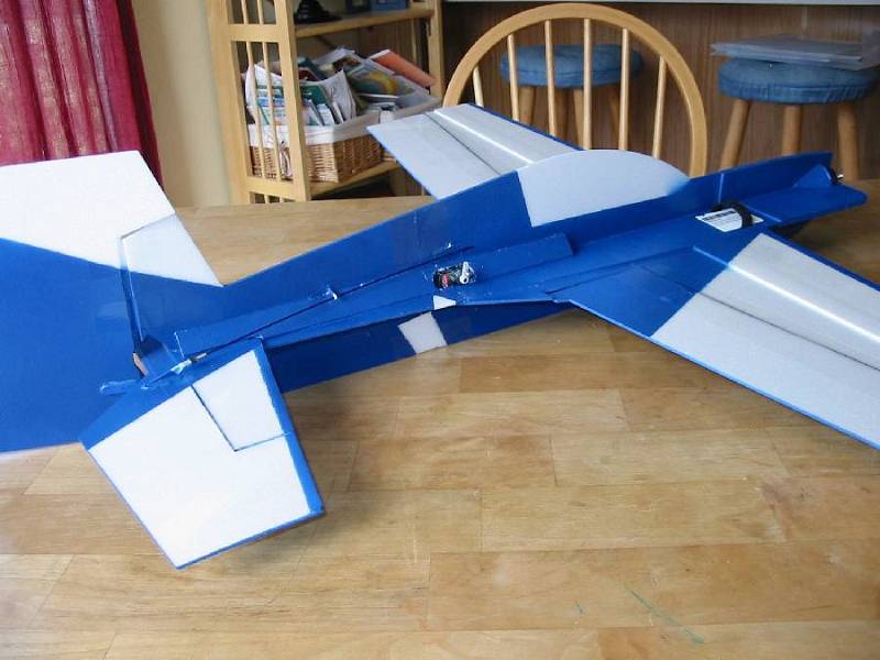

I installed the strips down the length of the tail at a 45-degree angle. I think I understood you correctly.
Now working on servo placement. Nothing made permanent until after painting.

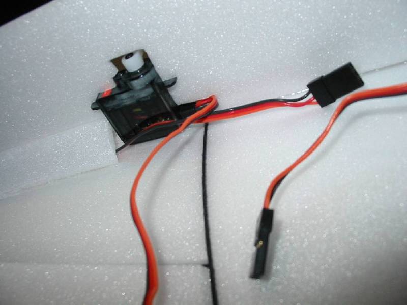

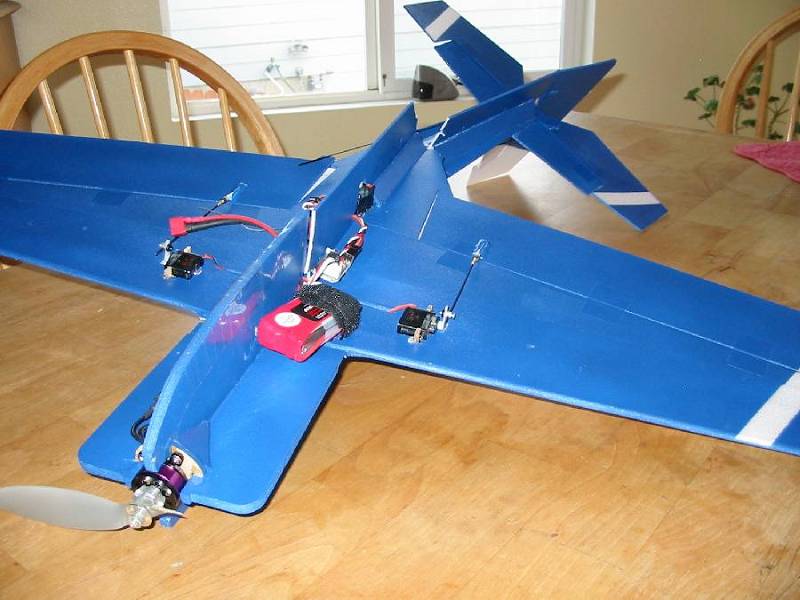

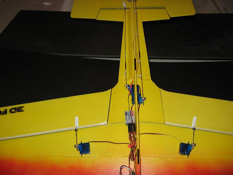

I put the elevator servo as close to the elevator as possible (limited by wire length). With my elevator servo control arm so close to the centerline of the plane, my control rod will have to angle away in order to find a section on the elevator with enough depth to host the control horn. I'm guessing this isn't ideal. Any thoughts or suggestions?
Didn't try quite so hard with the rudder servo to place if aft. Do you think it's too far from the rudder to have an effective pull/push setup with the carbon rod in the kit? Should I switch to pull/pull?
Is the red tube in the kit shrink tubing? If so, I'm guessing I'm supposed to CA the carbon rod into the threaded brass part of the clevis, and then shrink tube it for additional joint strength. Correct?
Nathan

Here, maybe this pic will help.. The red is tube to glue to the fuse for the pushrod to go through. The carbon control rods get ca'd into the gold threaded parts and thats all.

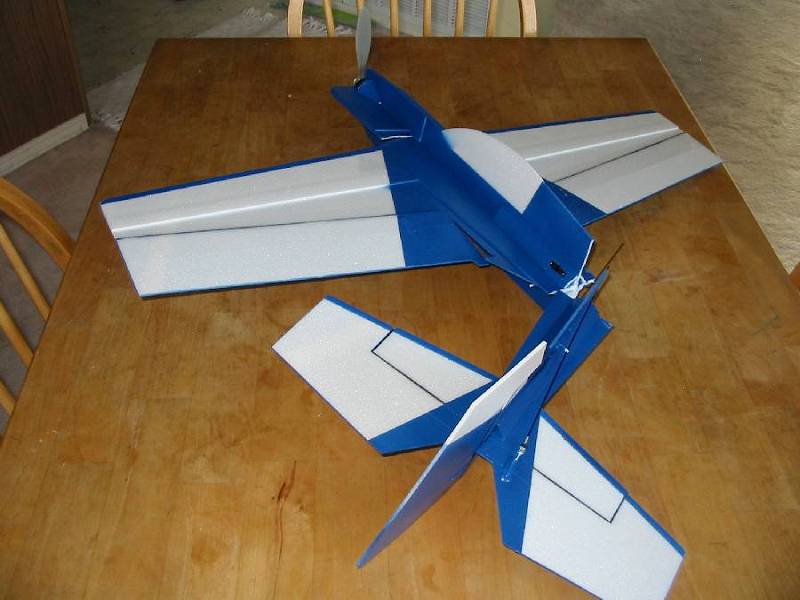

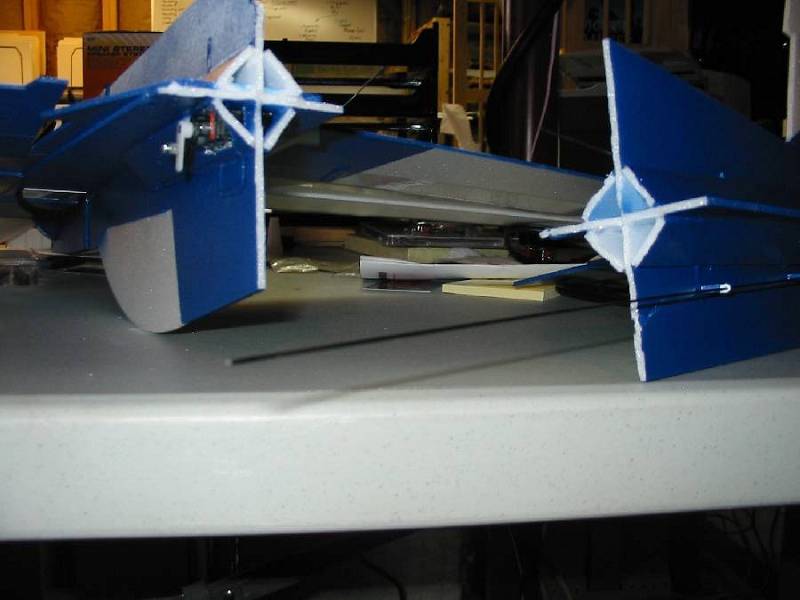

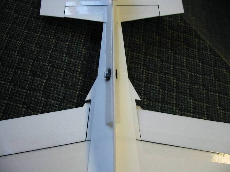

Well, I finally finished building my Mini Katana. It's weighing in at around 11.2oz. I attribute the extra weight to paint & glue. Probably a little anemic when it comes to 3D, but plenty of power for normal flying. Besides, the 3D will be further down the road...after I remember how to fly normally.
I went out and flew it today. After having knocked off only a little rust with RealFlight G3 down at the hobby store (10 days ago), I boldly ran up the motor and let her loose. It was fun for about 5 minutes, but then I started thinking about how I'm going to land this thing without crashing. It has no gear. I started making low passes. On one of those low passes, headed straight toward me, I got my left and right mixed up. Cartwheel. Broke the prop. Snapped the fuselage in three. Empanage held on only by control rods. "Firewall" forward almost broke loose.
A little CA & some scrap foam to fill in the missing section. Gotta go buy another prop. I think I'll spend a little more time with RealFlight when I'm at the store.
