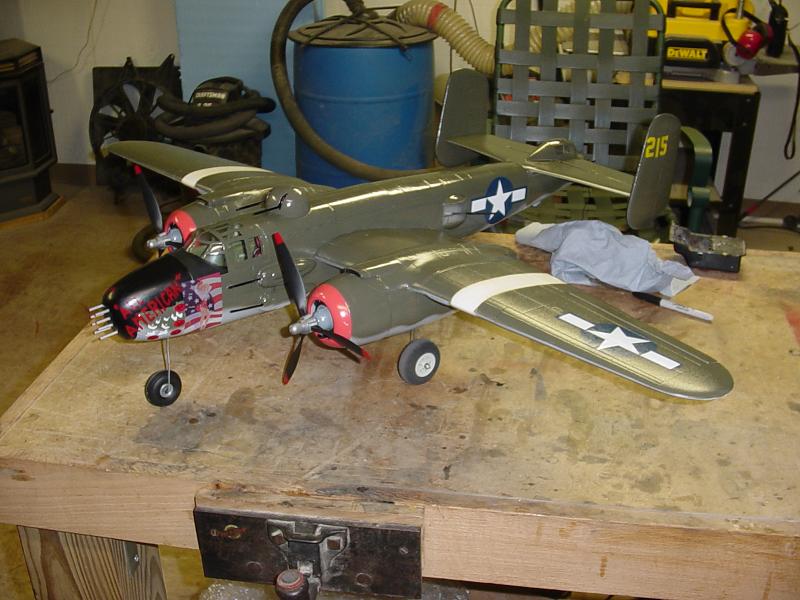

I tried the parrallel esc thing on mine, I used Tower Pro 2410-9Y motors and their 30 amp esc's.
Mine developed a quirk where unless I powered up the left motor first, the right one would not run. Finally got tired of it and snipped one of the red leads. Problem solved.
Good deal on the motor/esc, $12.00 and $28.00 for each. Got them here www.aarchobby.com
Tony's been a joy to deal with, and I usually get my stuff in 4 days from Hong Kong.
My set up runs 6 servos. 2 aileron,2 elevator, 1 steering, and 1 for the air retracts. Seems to handle it fine on one esc powering it
I liked the set so much I used it in my B25 too.
Very low amp draw from these motors(970kv) the B25 pulls 16.9 amps combined, so I run it on a single TP3S2100 pro lite to keep the weight down. I run 2 of them on the P38, mounted
under the main canopy.
